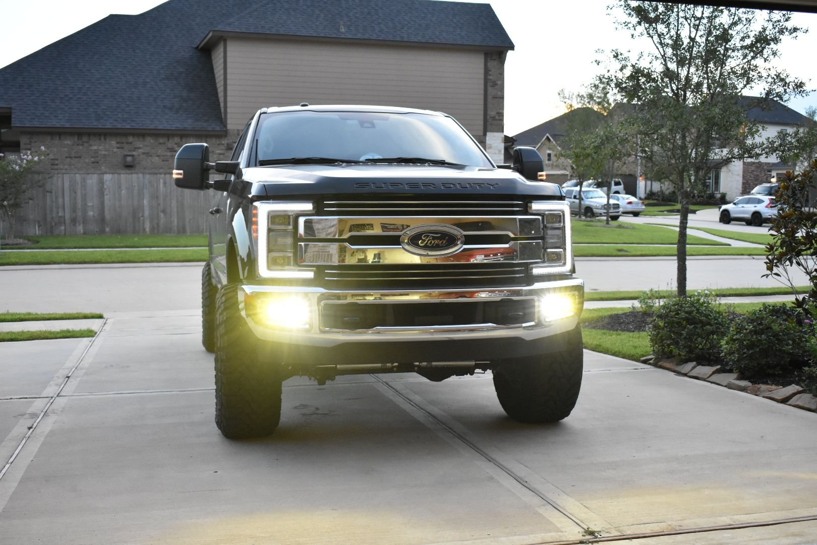

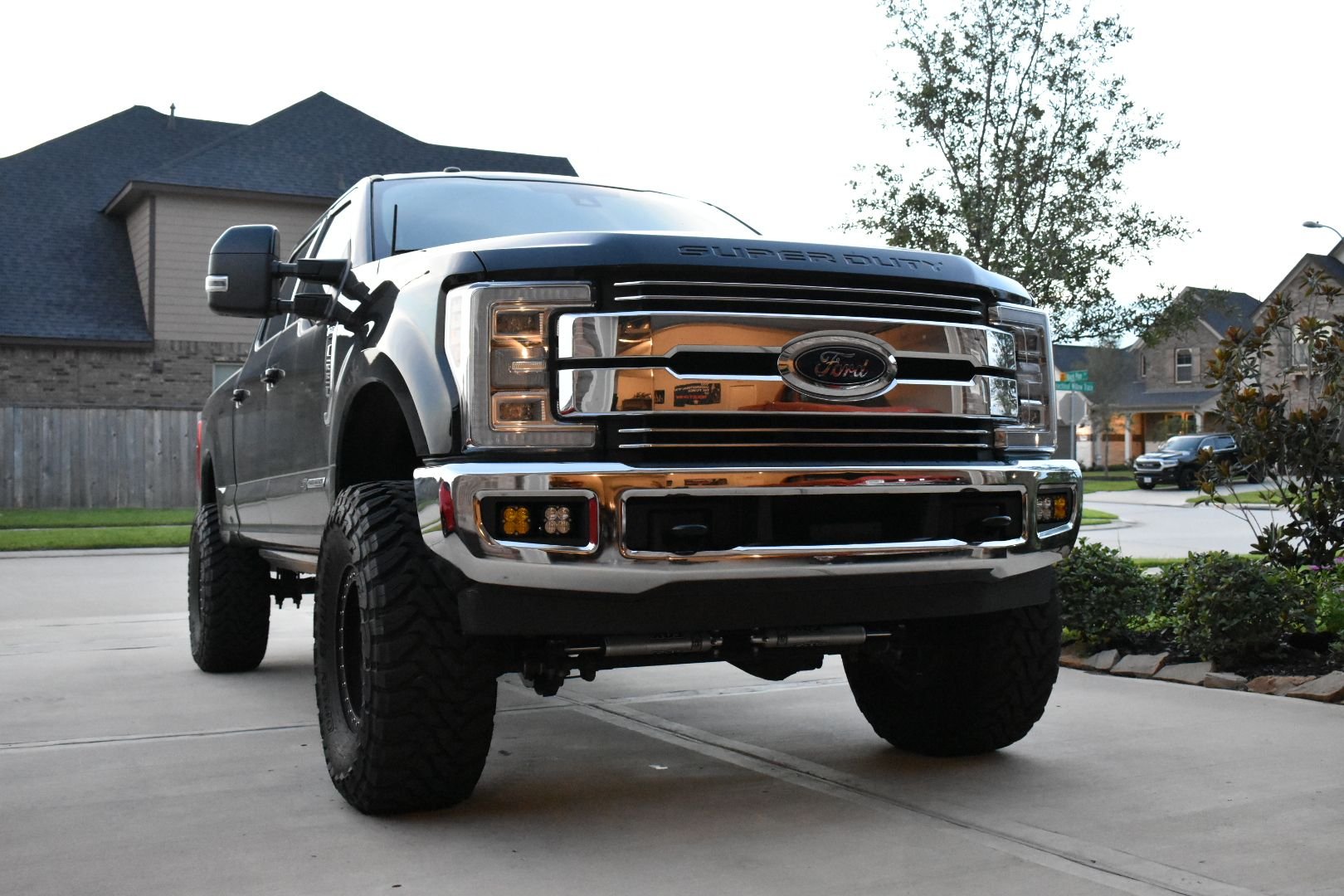

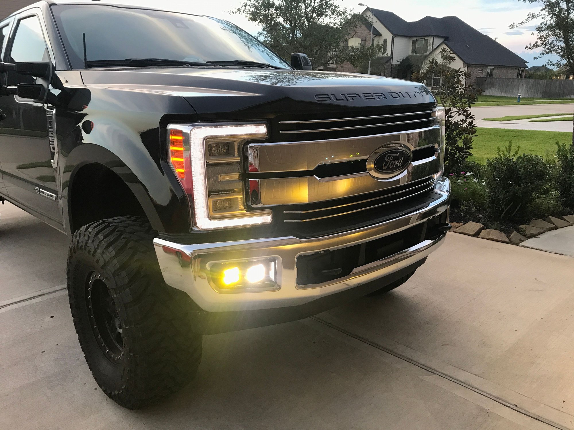

I installed four Baja Designs Squadron Pro pod lights in place of the existing factory LED fogs. The light output is insane! They have different lenses that disperse the light differently; one specifically call their "wide/cornering" lens puts out a very wide light pattern and would probably give you that wide angled light you're looking for.
I used the KD Fabworks mounting brackets for the four (4) new Baja Designs Squadron Pro's. I was able to plug-and-play the white pair back into the factory fog light wiring with the wire connection adapters that came along with the brackets from KD Fabworks; allowing for the exact same operation as the factory lights before. The second amber pair is connected too with a plug-and-play (basically) harness I purchased from Baja Designs, to the #1 upfitter switch. Everything in terms of wiring and installation was great, I only needed to make one wire splice to the blunt end wire for the #1 upfitter.
