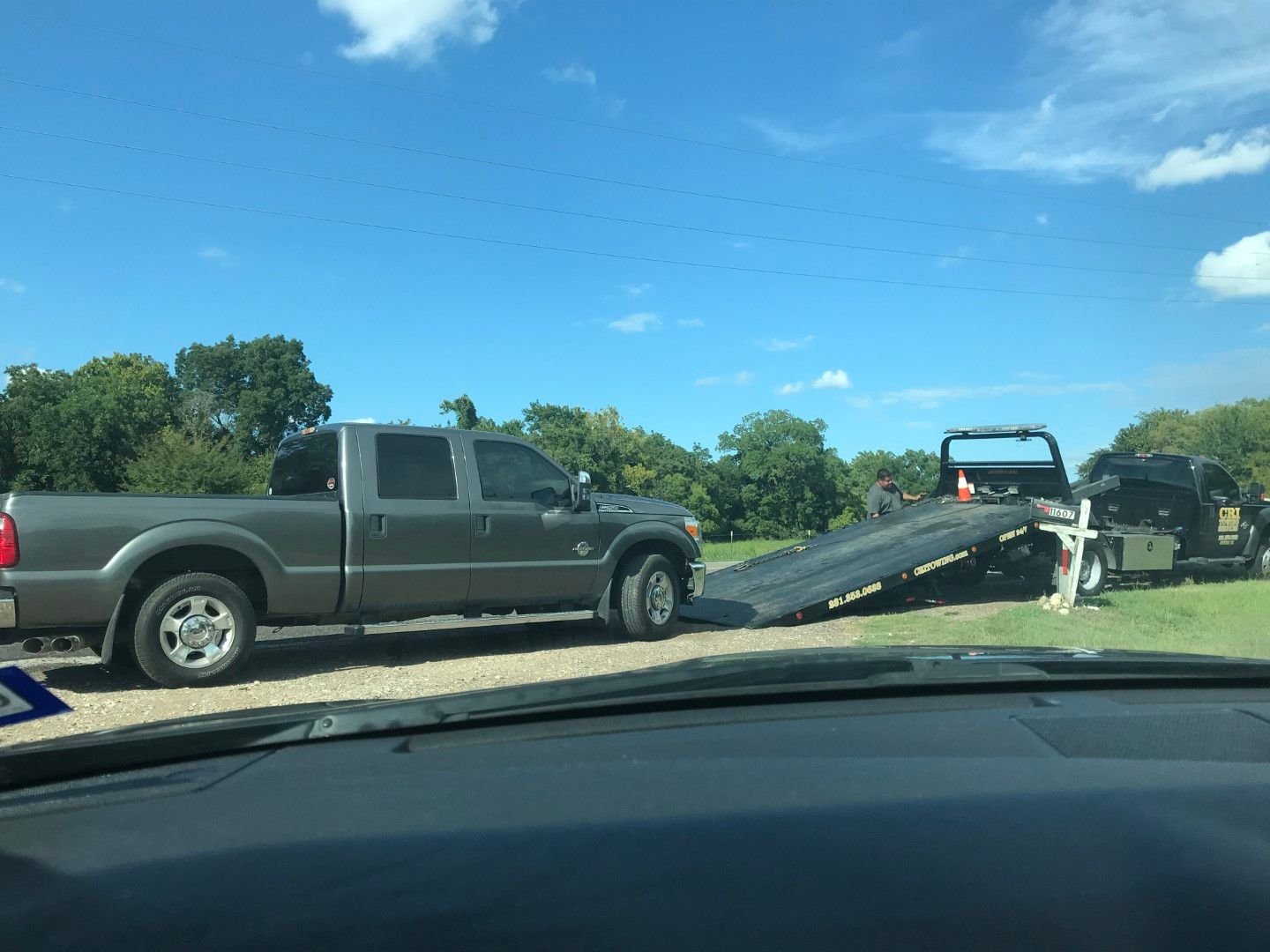

But went downhill in a hurry. We got to the campground, all was well. We did some antiquing, putzed around, found a nice little hole in the wall cafe, and day 2 was supposed to be more of the same. But as I was driving the truck over a hill, the diesel started dieseling loud. Then louder. When I stepped on the gas, it was even louder. So I got to a place where I could pull over (right in the middle of someone's country driveway), as I slowed and finally stopped, the truck was shaking like a magnitude 10 earthquake. I shut it down and that was that. It gave no warning, no lights, no bells, no whistles. Just the increasingly louder dieseling and the shuddering, then dead. It is now at the dealer, waiting for them to open and spring the bad news on me. Crap! CRAP!!
