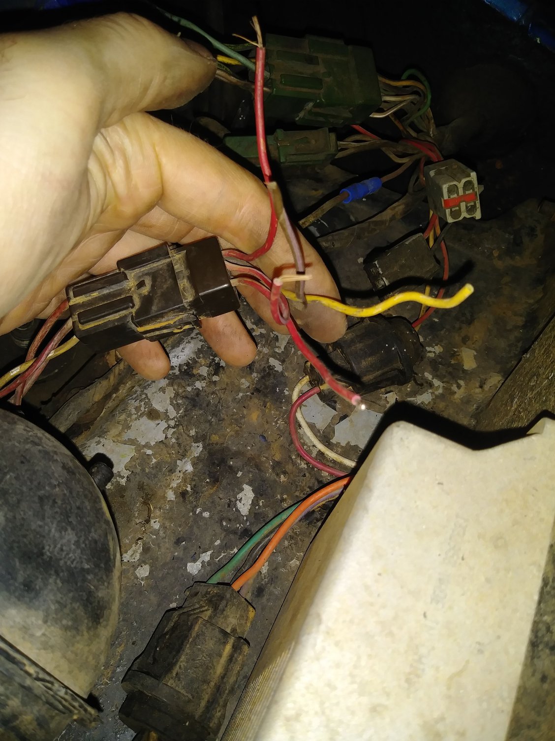

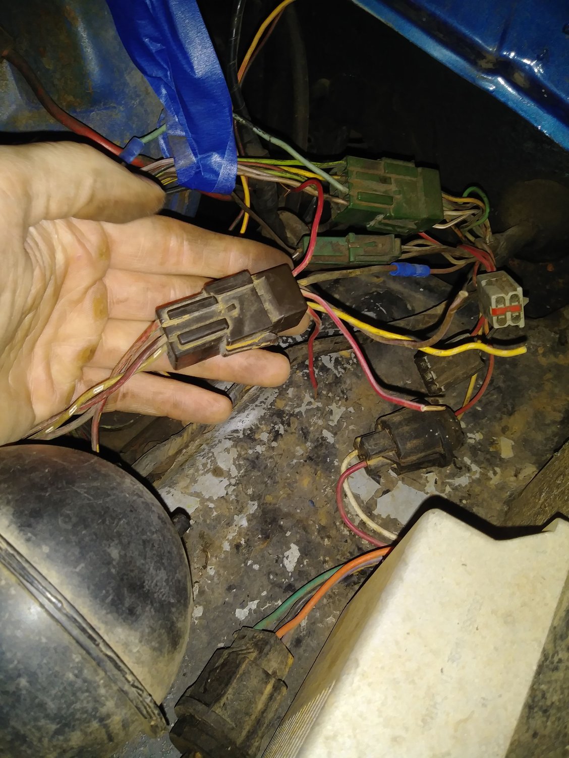

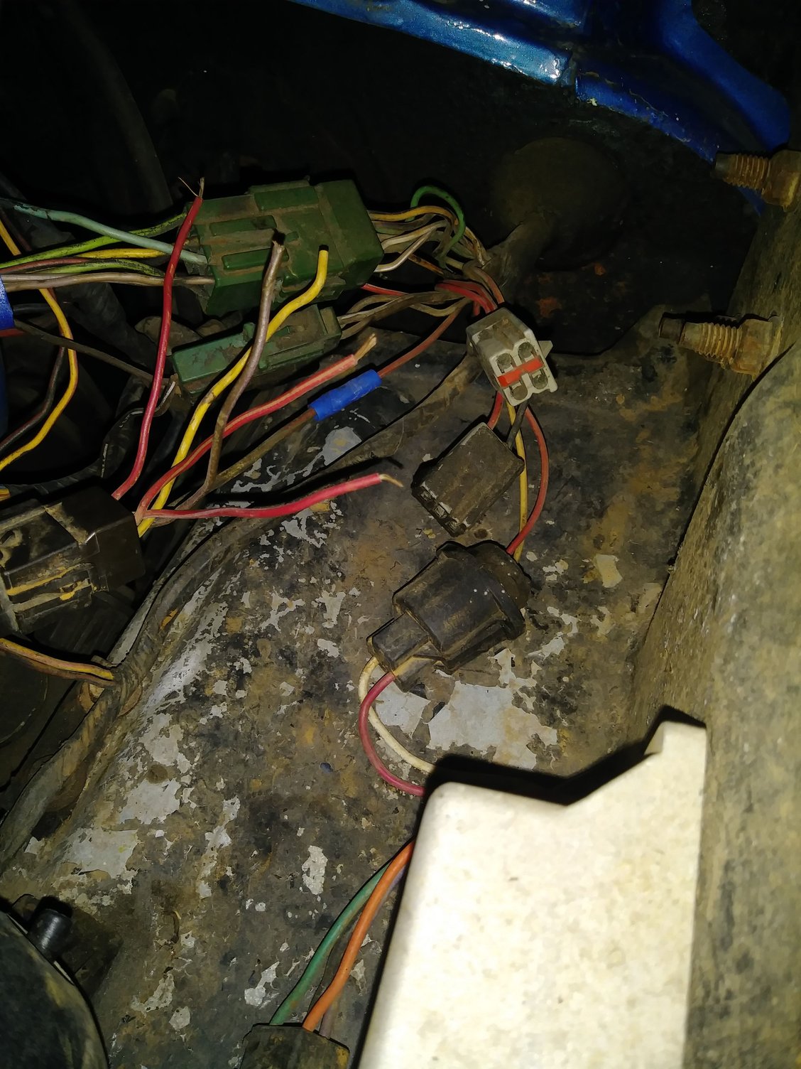

My 78 ford is a bit of a Frankenstein: 460 swapped onto a 1/2ton frame with a f250 body on it. All done by a previous owner.
Ive been slowly rebuilding it and getting it running....but the owner did less than a stellar job electrically mating the 460 in in the engine bay, and after seeing a post of someones square body burning up randomly in their driveway....im a bit worried lol.
my truck has a fire extinguisher in it, #1. BUT, id also like to know any wiring tips or tricks to prevent any electrical fires.
All my glass fuses are good and are the proper sizes...and I remove the battery when she goes back into the garage and not in use.
I saw in the tips and tricks section that someone mentioned that the headlight **** is a firey spot? I didnt understand the recommended fix though.
So, what advice do you guys have? Any horror stories and how to prevent them?
I'm running a 460, C6, 203 combo with the standard 1/2 ton axles...wiring in the cab seems to be farely factory....wiring in the engine bay has been half assed. Seems like just enough was done to make it run. I had a shop wire in all my gauges, so they'd work.
Thanks in advance guys!
