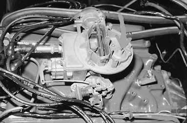

Starting in 70 ford started using this auto choke pull down diaphragm that opens the choke butterfly at the top of the air horn that's shown
in this picture.
This over chokes the engine at idle an must keep working the gas pedal to keep it going..
But does sound more like a vacuum issues, Also check the dizzy vacuum advance diaphragm canister not working an sucking air..
