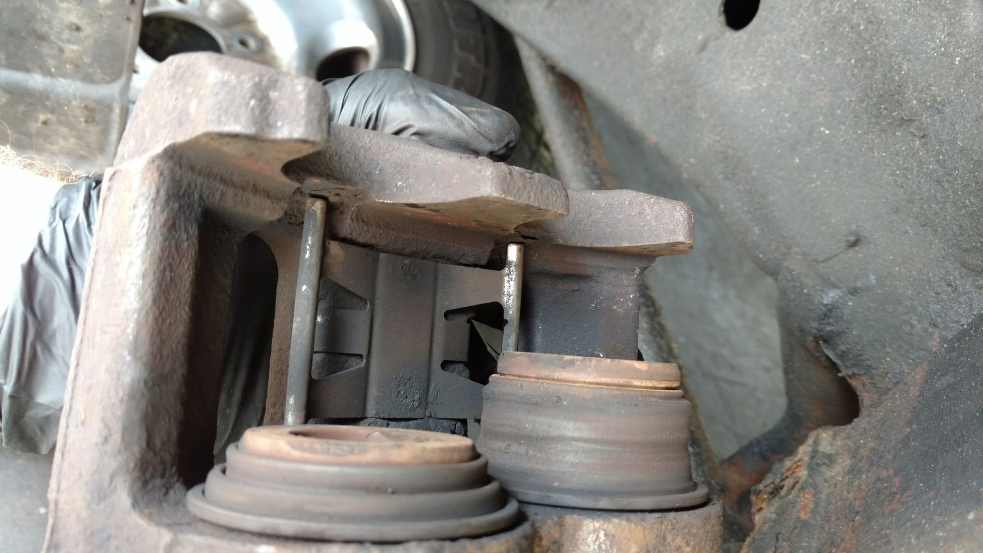

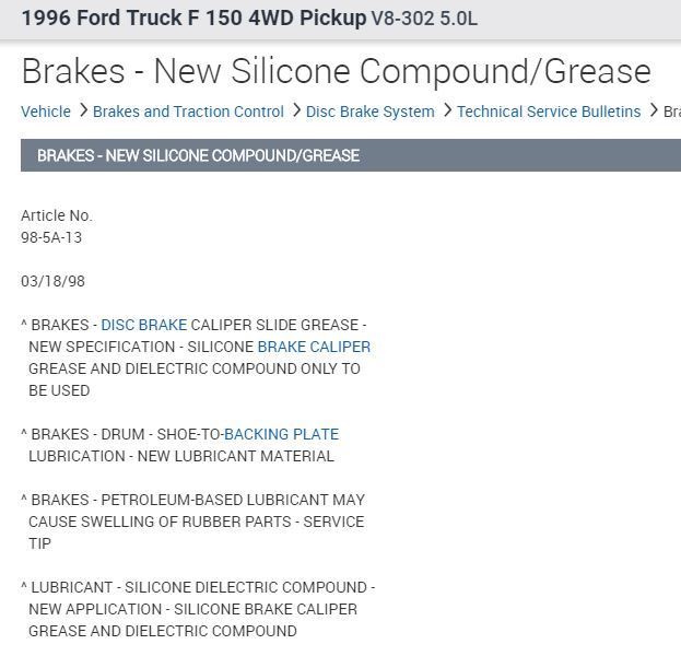

I would start with cleaning/lubing the caliper pins/slides. If that doesn't help, you may need new calipers.
