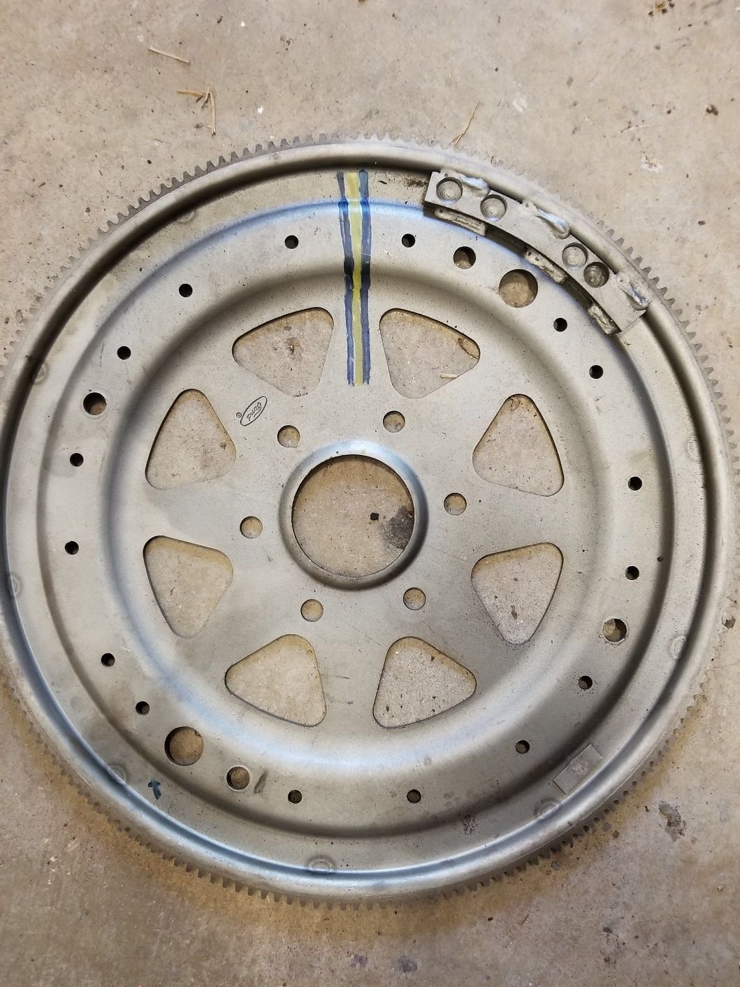

Long story short I got a 428 (short block already assembled) that was built by a gentleman who had passed away. The son sold it to me and was fairly familiar with it but obviously could not answer all of my questions since he was not the one who built it.
I was told it had been balanced, has a polished 1U crank, and see signs of such on the pushrod caps. The harmonic balancer it came with appeared to be drilled for balance, as well as the drilled weight on the flex plate. The flex plate was not attached to the crank when purchased but came with this build. The flex plate was not attached either but came in a box as well as the rest of the remaining parts of the engine.
I have a 428 flywheel coming as this is going to mate to a NP 435. I am stuck and uncertain if I should match balance my new flywheel to the flex plate that came with the engine, or should I have the new flywheel zero balanced? The machine shop I called said the 428 was internally balanced and the flywheel will either need to be match balanced to the flex plate, or the entire rotating assembly, harmonic to flywheel balanced as one. What should I do?
I attached pictures of the flex plate and harmonic balancer that came with the engine as well as the crank assembly

With that amount of weight on the flex plate the engine is still externally balanced, you need to have the fly wheel match balanced to the flex plate

Thank you I will have it match balanced then. I just wanted to check before I do something dumb!

x 2 have the flywheel matched to the flexplate.
