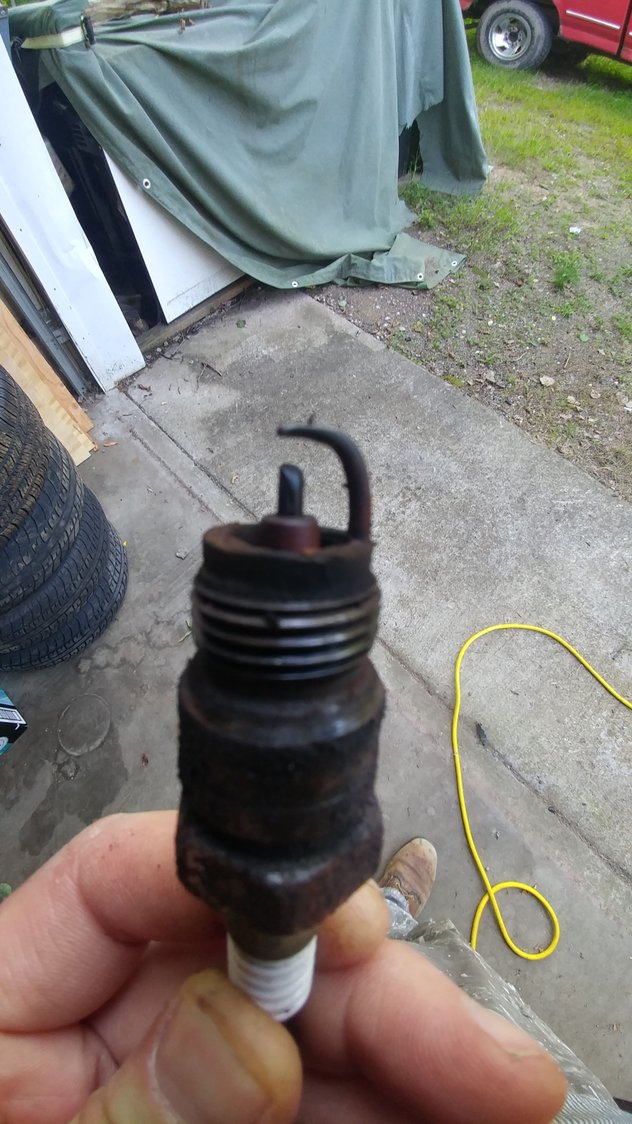

im guessing the spark plugs shouldnt look like this.....looks like i will have to order some parts and get back to it later.

Once you have #1 at TDC you will know what timing mark is legit. Those plugs are long past best before date, time for a tuneup.
