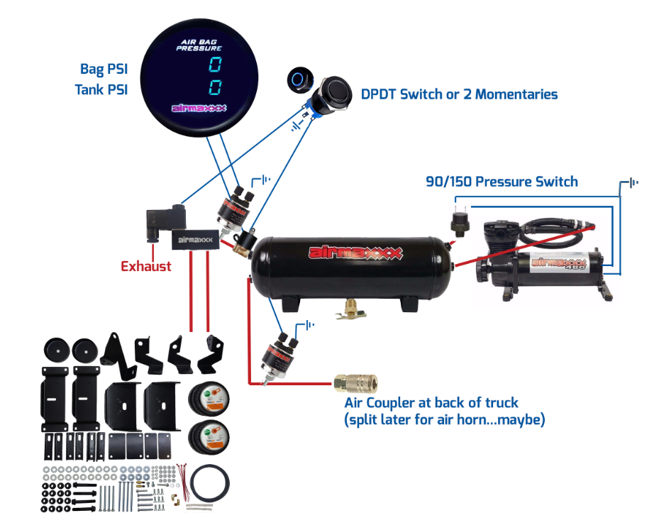

For $450 I bought an Airmaxxx 580 compressor, 3 gallon tank, electric solenoid for airbag fill and one for dump, 2 electric PSI sending units, a dual PSI gauge (tank psi and bag psi) and the Torque air bags. Took a few hours to install everything but I couldn't be happier. The tank sits at 150psi and has a coupler for filling truck/trailer tires as well as another port for an airhorn down the road if I'm ever feeling randy.
Hooked it up to two upfitters, one fills the bags (insanely fast) and the other dumps them. This wasn't a kit, I just sourced all the parts individually, was a fun project that I have already used so many times I can't believe I didnt have it sooner.

I don't have links, I purchased everything separately from all over the web and locally, but its all commodity hardware. Any 12v momentary solenoid will work for the dump/fill ports. The bracket I just made out of Unistrut and threaded rod, was super cheap and amazingly sturdy.

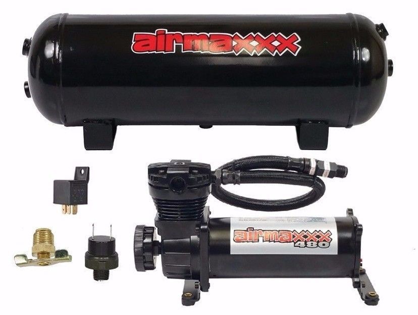

Air Tank and Compressor I bought from Airmaxxx, similar to this kit. I got it for $130 shipped:
http://www.ebay.com/itm/Air-Compress...AAAOSwgmJXxz4Q
The rest I just purchased from my local industrial parts supply place. Some fittings for the tank, coupler, DOT hose, blow off valve, etc. The Torque bags I bought from a website call expedition portal if I remember correctly. The link is in the other air bag thread.
