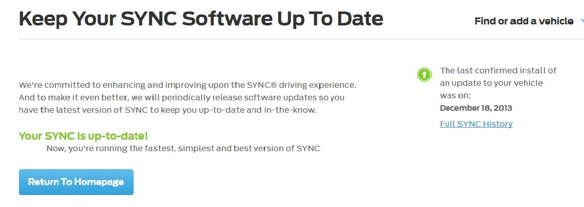

I recently bought a 2014 F-450 King Ranch with the Sync 2 in it. I immediately started looking for a software update for the Sync but the Ford site tells me there isn't one available and my truck was last updated in December of 2013. That can't seriously be right, can it? Surely there has been at least one software update since it's release? I had a Pioneer AVH-4200NEX in my 2002 F-250 and honestly, so far I liked it better. The only thing really holding me back on ripping the Sync out and putting the Pioneer in are the vehicle and climate settings available through the Sync but, I think I can get around all that with the Maesto so, if there really isn't a software update available, I'll probably go that route. I'd like to add a 2nd camera for gooseneck hookup anyway.

The SYNC system seems like they rarely updated their software/hardware. And when they did, it usually broke something. I had to backdate the last one on my 2011 because it broke some basic functionality with my iPhone. That message above is probably correct.

First off, you do not have the Sync3 setup that Ford has installed in the newer vehicles (some 2016 and all 2017 and newer). Your sync is Sync2 version 3.08 or version 3.10.
To upgrade your Sync2 to a late model Sync3 setup, you would need to spend upwards of $1200 to $1600 or more.

Sorry, I corrected it. I'm not looking to upgrade to the most current hardware, I am astonished that they haven't released a software upgrade since 2013. If this is the latest software, I'm going to yank the head unit and go back with the Maestro and Pioneer head unit. $600 and a couple of hours will give me everything I want, I believe. The only thing I'm not 100% on right now is that it'll retain the heated/cooled seat controls as I don't have buttons for that since I have the upfitter switches. If I lose that though, I'll figure out a way to wire in buttons, honestly I'd prefer that anyway. I think they should have been buttons on the door with eh teh power window controls where they're easier to reach.
