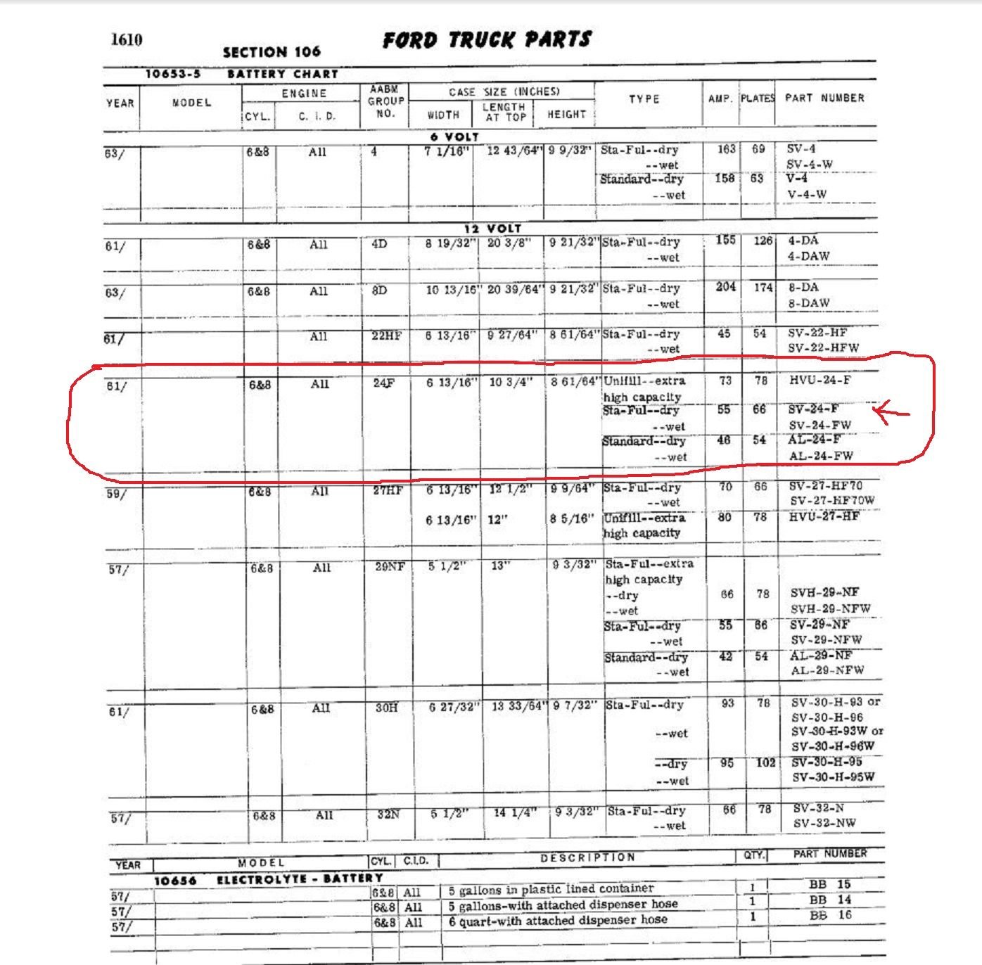

Freightrain -- Thanks for your reply. When I remove caps 2-3-4-5 I can not see any water or plates like a normal wet battery. There are round plastic inserts that are in each cell (2-3-4-5) just below the cap bottom. I am starting to believe that this is one of the Sta Ful AGM battery that use a Autolite Sta Ful case copy and do not use the two end cells. As I understand the company that was making them has went under and the quality of the battery was not so good.
matthewq4b --- Thank you for the printout of the Ford Truck Parts manual, section 106 that shows the Sta Ful SV-24-F (dry) and the SV-24-FW (wet) units listed. They both use the same Sta Ful Autolite case with 55 Amp & 66 Plate in raised letters on the case end. I think as Freightrain said that they only needed to use 4 cells to build the dry SV-24-F battery & they left the two end cells empty.

You battery is reproduction AGM (Absorbed Glass Mat) battery, Conventional batteries like the original 24-F are a flooded lead acid battery. When these old style batteries are charged they out gassed some of the water in the electrolyte was converted to Oxygen and Hydrogen and was out gassed, eventually the level of the electrolyte dropped and would need to be topped off with distilled water.
In the supposed maintenance free (they really were not) or valve regulated lead acid battery, the hydrogen and oxygen produced in the cells is largely recombined back into water but the electrolyte level will over time diminish.
The SV-24-F is a dry battery meaning it was shipped dry with no electrolyte in it and would be filled at the dealership when sold. Dry batteries have an almost unlimited shelf life .. The SV-24-FW battery was a wet battery meaning it was pre filled with electrolyte before being shipped. That is the only difference.
AGM Batteries were developed in the 70's for the military, and did not see wide spread use till the 1980's In AGM batteries the electrolyte is held in glass mats, as opposed to freely flooding the plates like a flooded lead acid. The electrolyte aslo does not cook off during charging. The popular Optima batteries are a spiral wound AGM.
AGM batteries can have equivalent cranking amps in a smaller case compared to a flooded lead lead acid.
Your battery is an AGM in a reproduction Autolite case.
Good quality AGM batteries can last many years, I have one that has been in service for 14 years in a daily driver.
But good quality AGM batteries are not cheap look to pay $300 plus for a good quality AGM.
The advantage with AGM's is they can be mounted in any position but upside down and with no outgassing you get no induced corrosion on the battery terminals and they can be mounted in a sealed compartment without having to provide provisions for venting.
