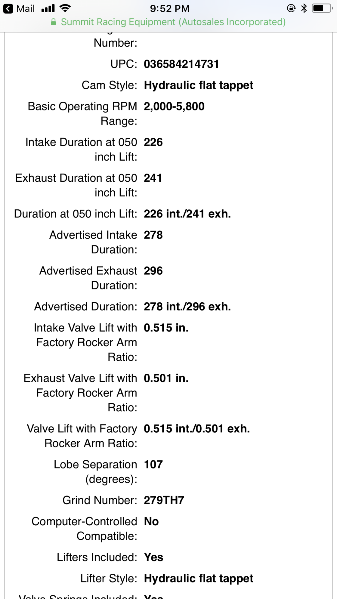

Posts: 57
From: Spanaway,WA
Here are my cam specs on the kit I got too.

That is the Comp Thumpr cam which is designed for rough idle and low rpm so it sounds like a big cam engine.
It has plenty of exhaust duration to help evacuate the extra exhaust volume from nitrous.
It also has 19.5 degrees of .050" duration overlap which means you definitely don't want the nitrous on before 2500 rpm. There would be a good chance of igniting the charge in the intake manifold.
An RPM window switch would help keep you and the engine safe.
