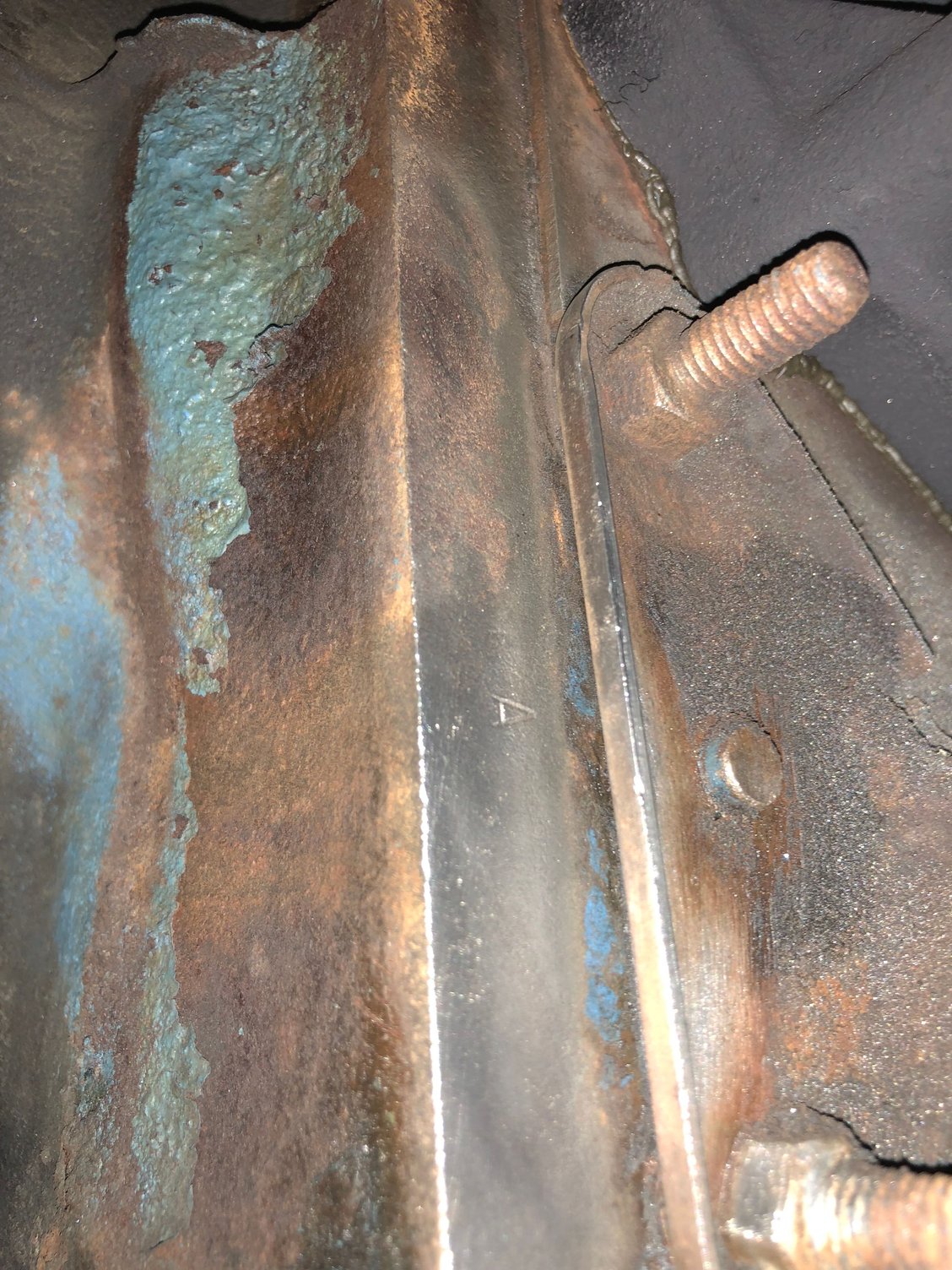

Are you looking at casting numbers? Or actual date numbers? A "D7TE...." number is a casting number. It just means the casting revision was done in 1977. It could have been cast in '77 or any subsequent year until another revision was issued.
Ford does not put VIN on engines, so you will never be 100% certain you have the "original" engine in that truck.

I was looking at the casting number, casting date and the build/ assembly date. It is a D7TE, with a casting date of 7B14 which should mean that it was cast the 14th of February in 1977. What I find odd is that the build/ assembly date of the engine is just an “A”. Normally it would have a year, month and day. Here are pictures of the casting number and date, and the build/ assembly date.
