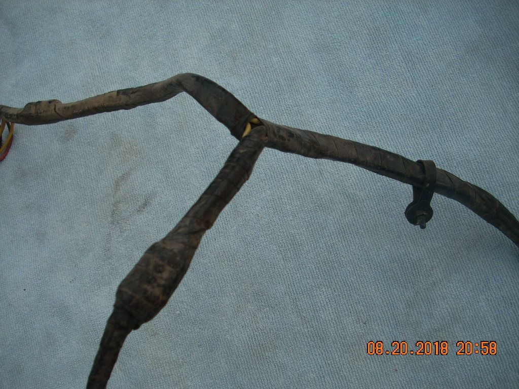

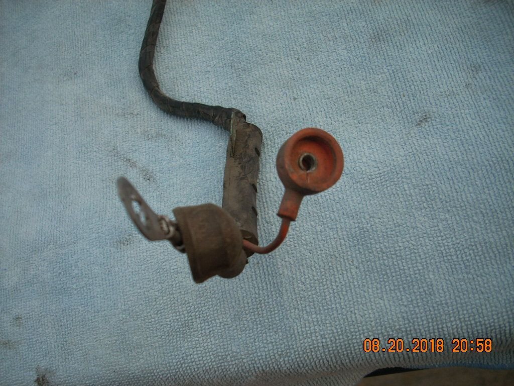

I'd take 50.00 for it plus the shipping charges. I will post a picture of it if you are interested in it. Just let me know.

It's in absolutely perfect condition. 50.00 plus shipping, I do paypal. I can get more if anyone else is interested. Thanks.
