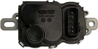

When you turn the key ON ( not start), the fuel pump should start and run for 3 seconds. You should get a couple ounces out of the line by doing that. As mentioned, the fuel pump module tells the pump to run and controls the pressure. That is mounted to the truck frame in front of the rear axle on the drivers side. It is a small black box about 3 inches square and 1 inch thick. Should be an electric plug into it... They are known to crap out after road salt gets on the case and corrodes.

should look something like this.......... look for corrosion on the aluminum back cover.

as you already know fuel cools pump don't let it get too low . But check out that fpdm . They all go bad . New ones mounted on standoffs to prevent steel to alum back plate electrolysis , once it gets a hole in it water makes it do strange things and becomes intermittent. Guess how I know .
