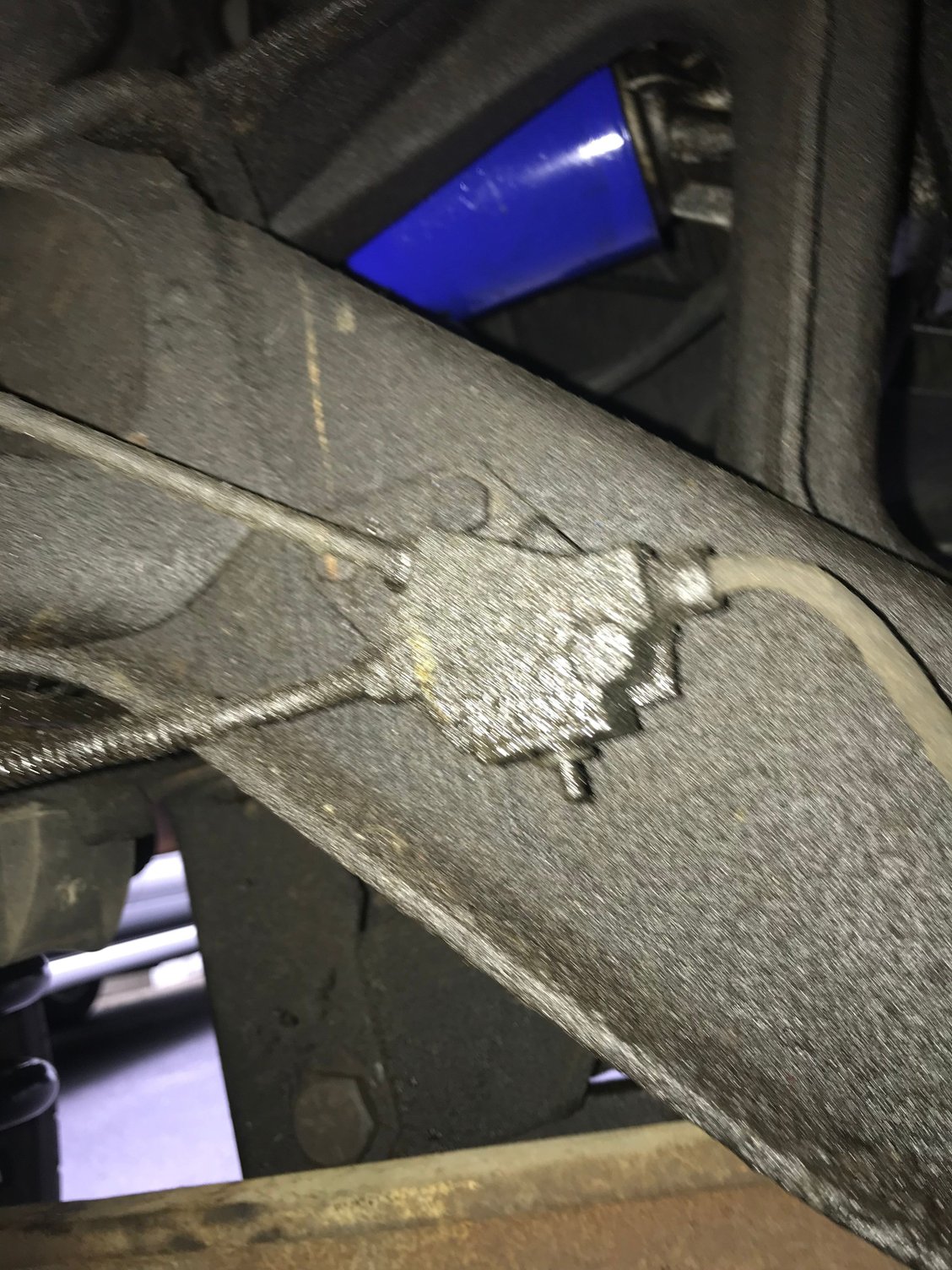

So let me clarify. When i first attempted a bleed, i got fluid out of the calipers. I did crawl under today and take a few shots of the main proportioning valve and what the one with the “rod’. Since I am 7500GVW i used a c-clap to push the rod in. While brake pressure was slightly (and I mean slightly) better still very soft. Here are some pics of what I am looking at. Thanks for your assistance
Front prop valve with rod.
Main prop valve

I've never heard of a separate one for the front, but I see that valve rod. Is there one like it on the main valve body, on far end not visible in the pic? I wonder if someone gutted that part of the main valve and then installed the front one to replace that function.

I checked but no there I nothing. I felt to see if maybe it was broken off or something but it’s flat and smooth.

The more and more research I am doing on these “metering valves’ it looks as if my 73’ brake system has components from a 72’
My brake warning light has been on since the day I got the truck. I have not seen any replacements, so I ordered a rebuild kit from musclcareresearch.
However any other tips to get this working would be greatly appreciated.

M proportioning valve looks like yours and is inside the driver side frame rail. I don't have the other.
