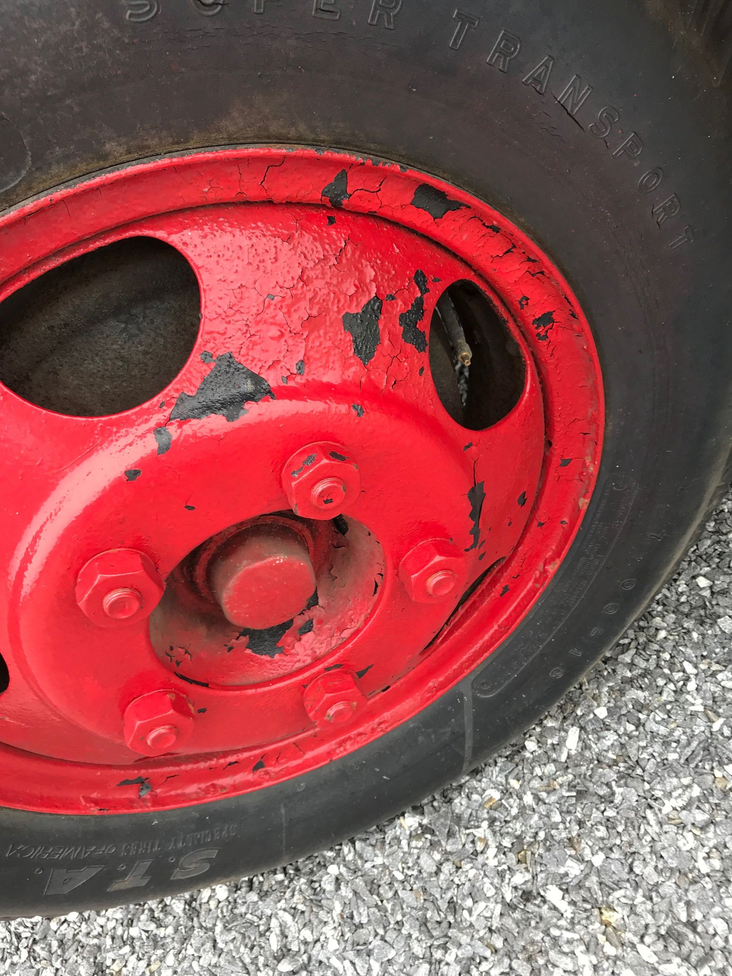

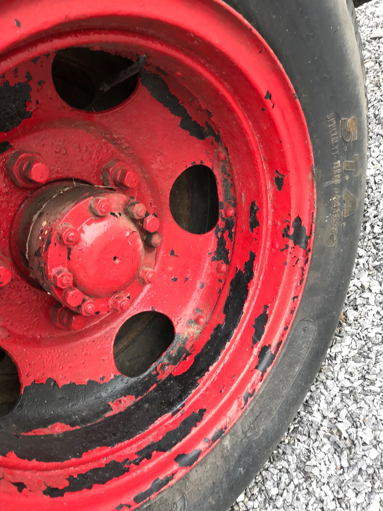

Hello, I am new to the group and need assistance with a 1948 F4. I need to determine first, if the rims on it are the dreaded widow makers.

Yep, The raised band on the concave side is indicative of the 'widowmaker'.

Yup, widow makers, you did your homework and your seller is dead wrong. (This is an extension of a conversation over on the 1947 and under forum). Hope you and Josh can firm up a deal. If I may suggest, the seller needs to drop his selling price to compensate for your wheel expense. Stu

48f4. Your wheels are in fact the widow maker wheels.
