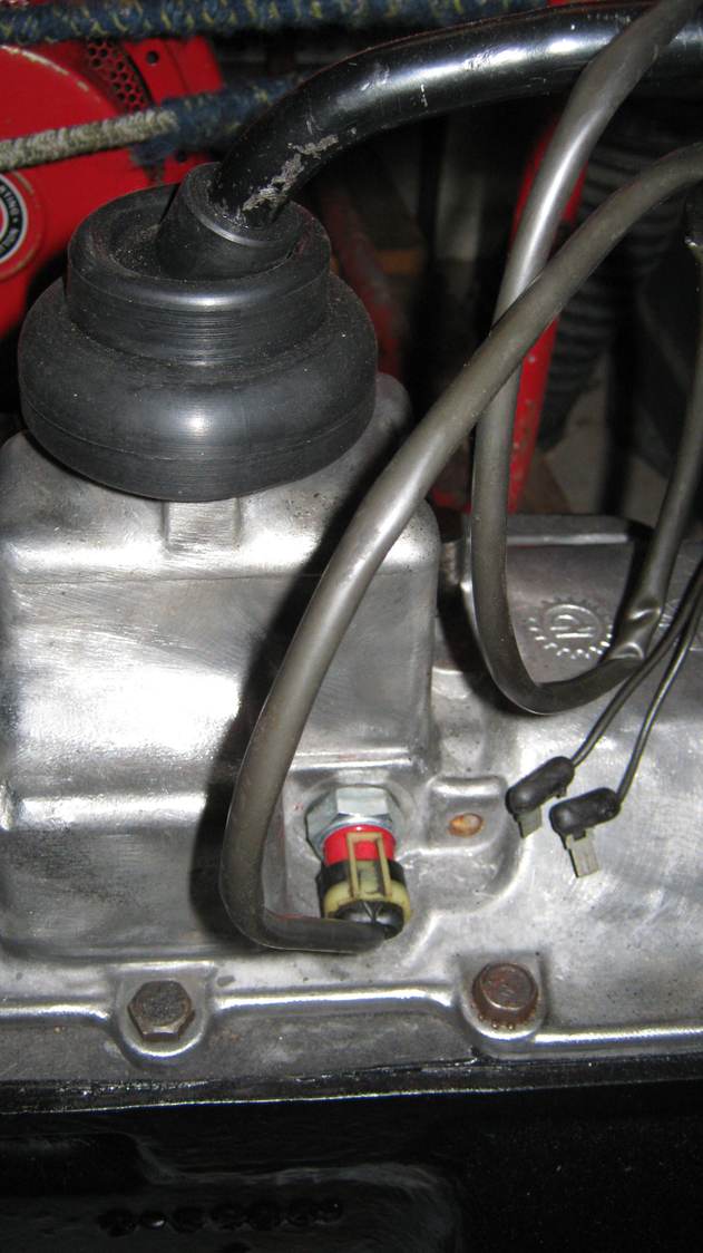

Thanks looks good... I spoke with Jim at Centech. I think I'm going to ditch the old wires all together . I bought new pigtails for the lights on Bronco Graveyard and a taillight harness from MR. Tail.. So I think the only old wires will be to the sending unit.
The only other thing I ran into were the wires in associated with the HVAC. I removed them from the old loom. I'm not totally sure yet how Ill get those back up and running

So any ideas on how to wire the backup lights. I have a manual tranny, 2 wire plug comes out. I get that one goes to the backup slot on the fuse panel, not sure how I run it to the light? Talk to Centech he wasn’t too sure, said he hadn’t done many manual transmission.
