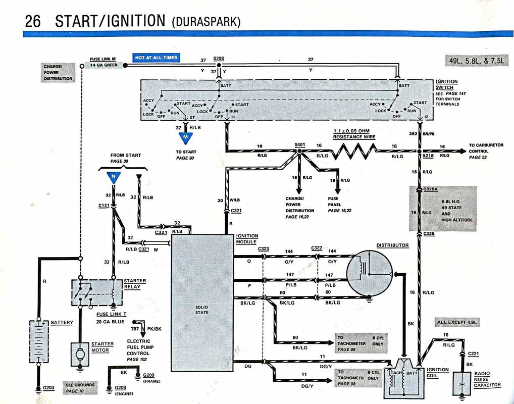

This is most likely your ignition system, this is from an 1986 book, I'm on the road, so I cant compare to my 1987 book.
