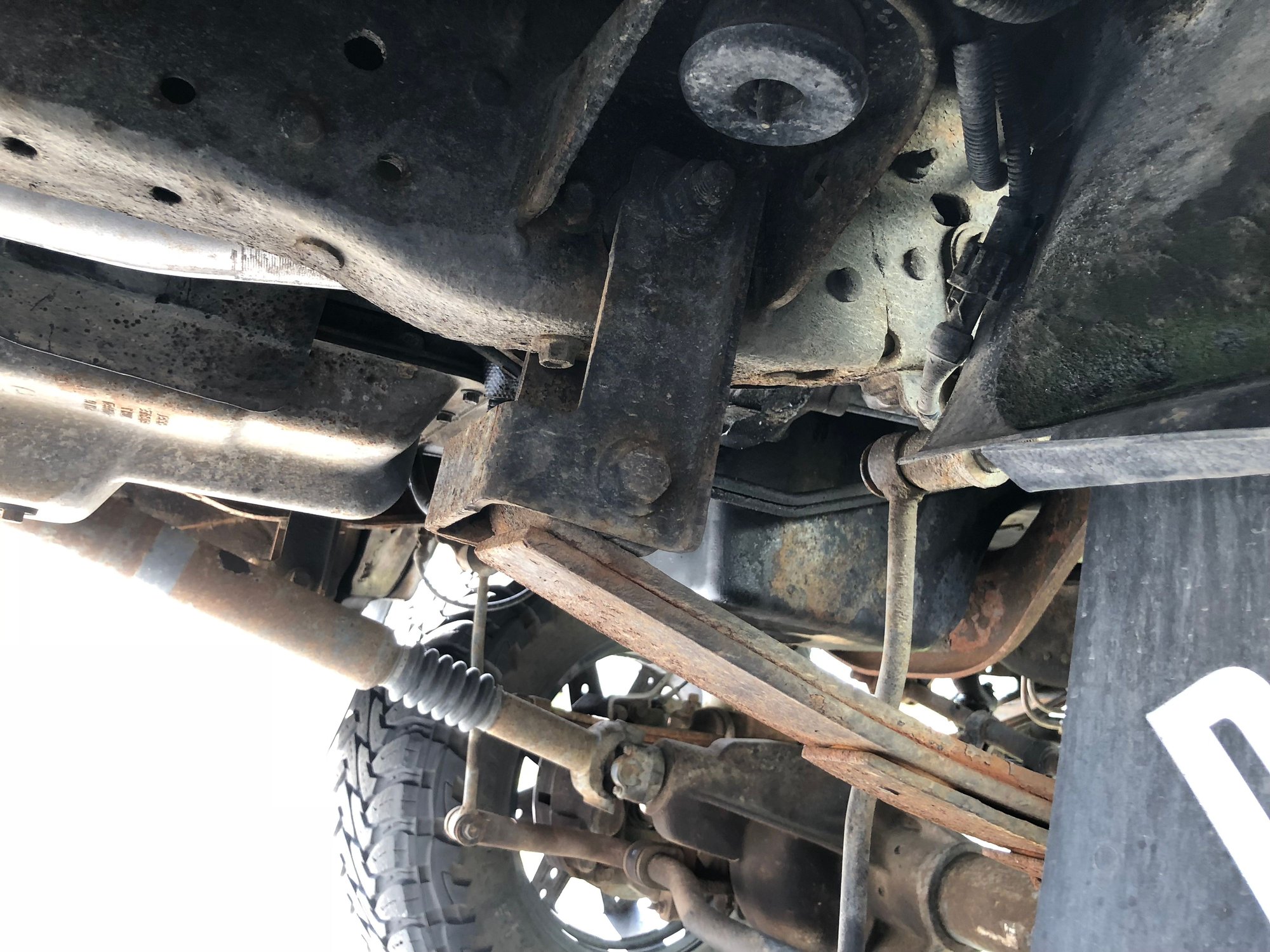

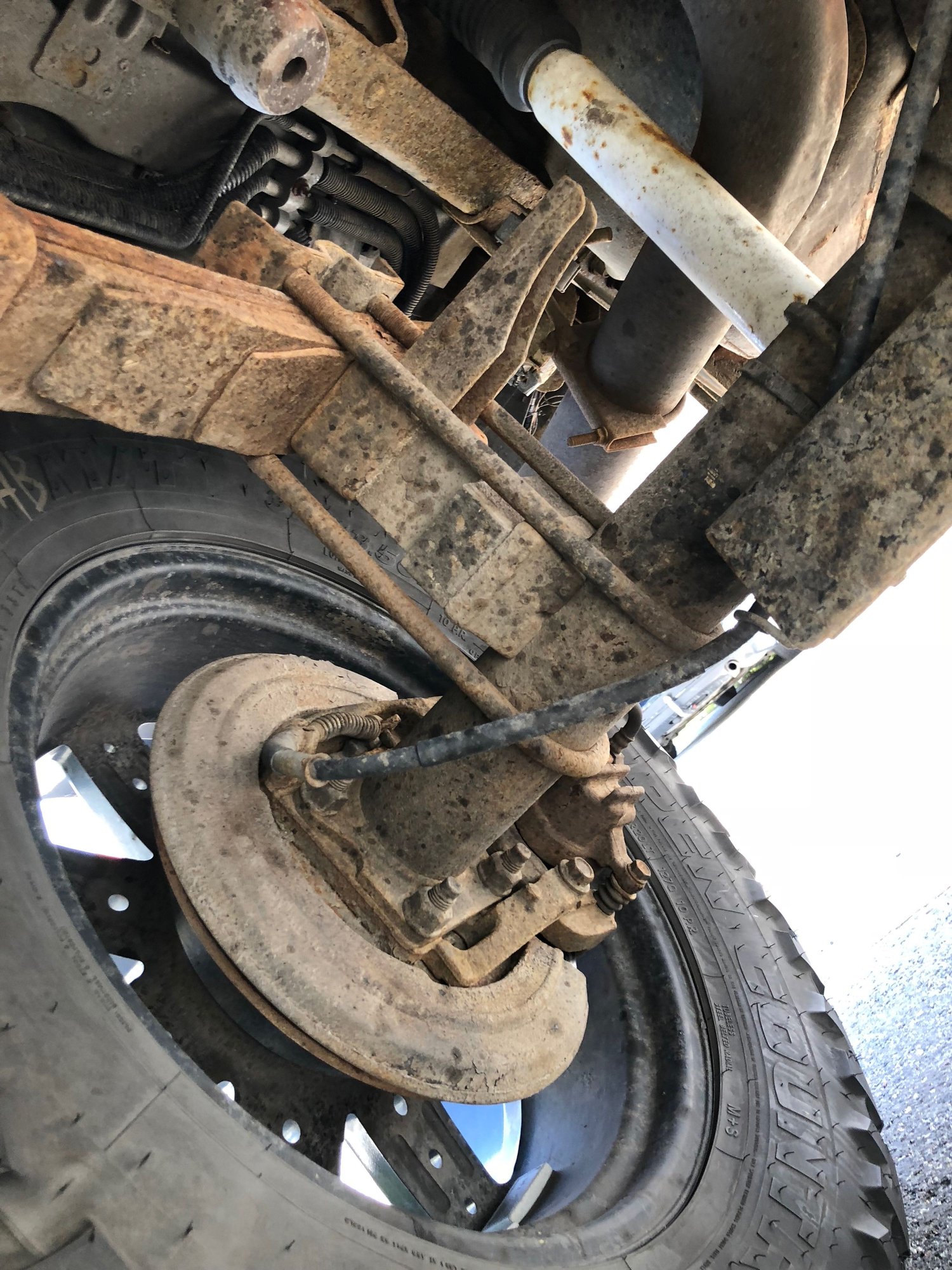

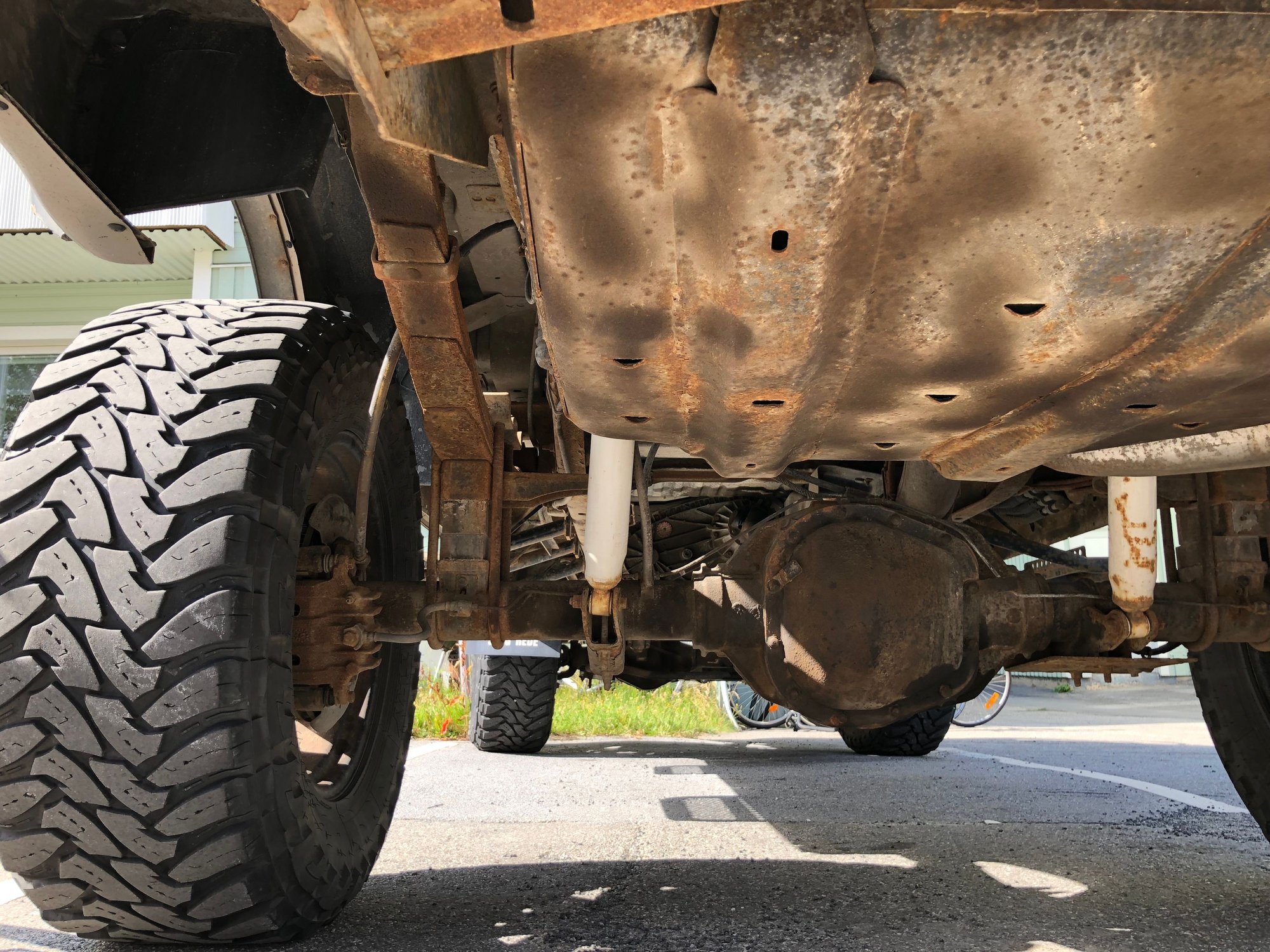

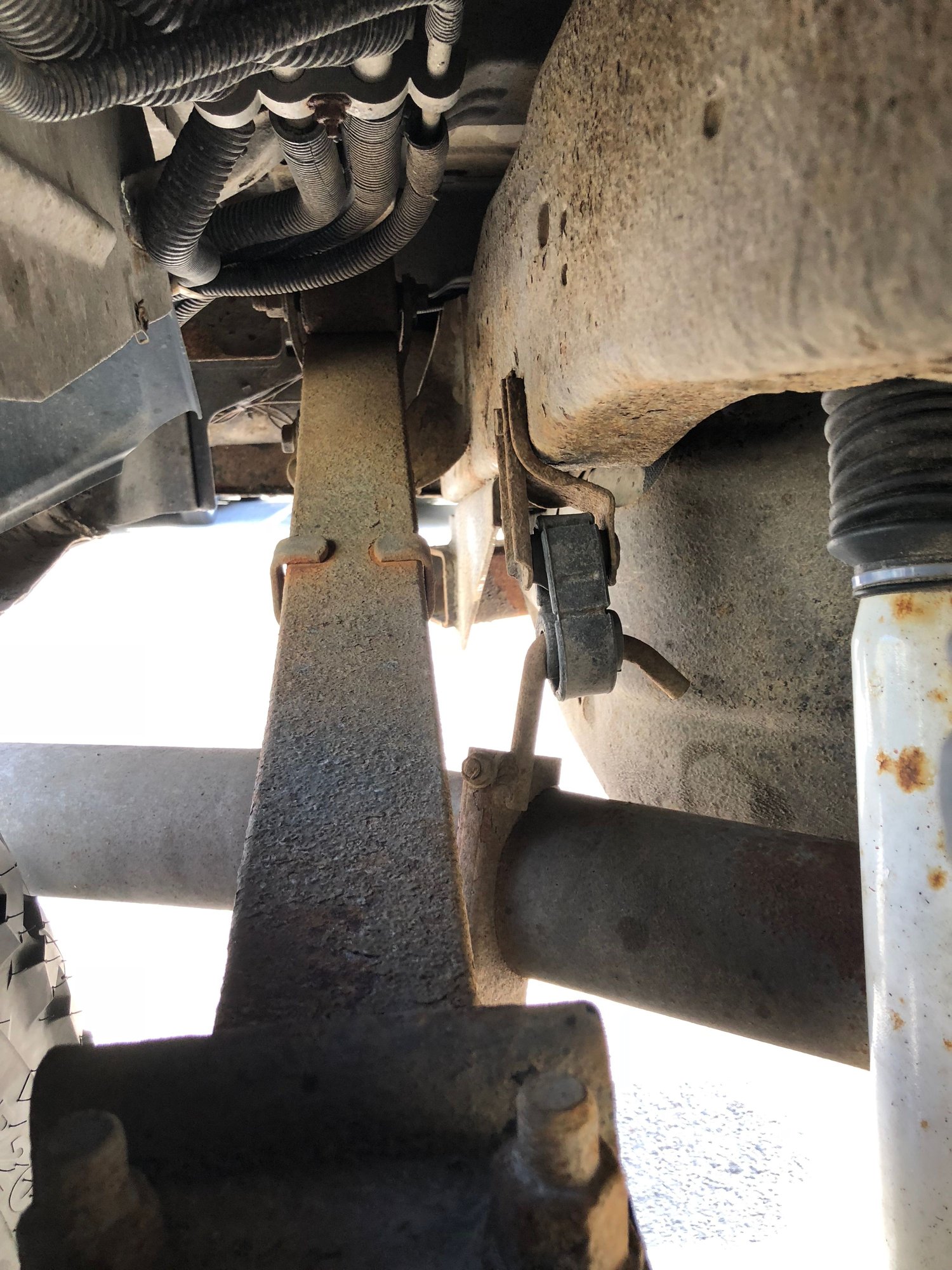

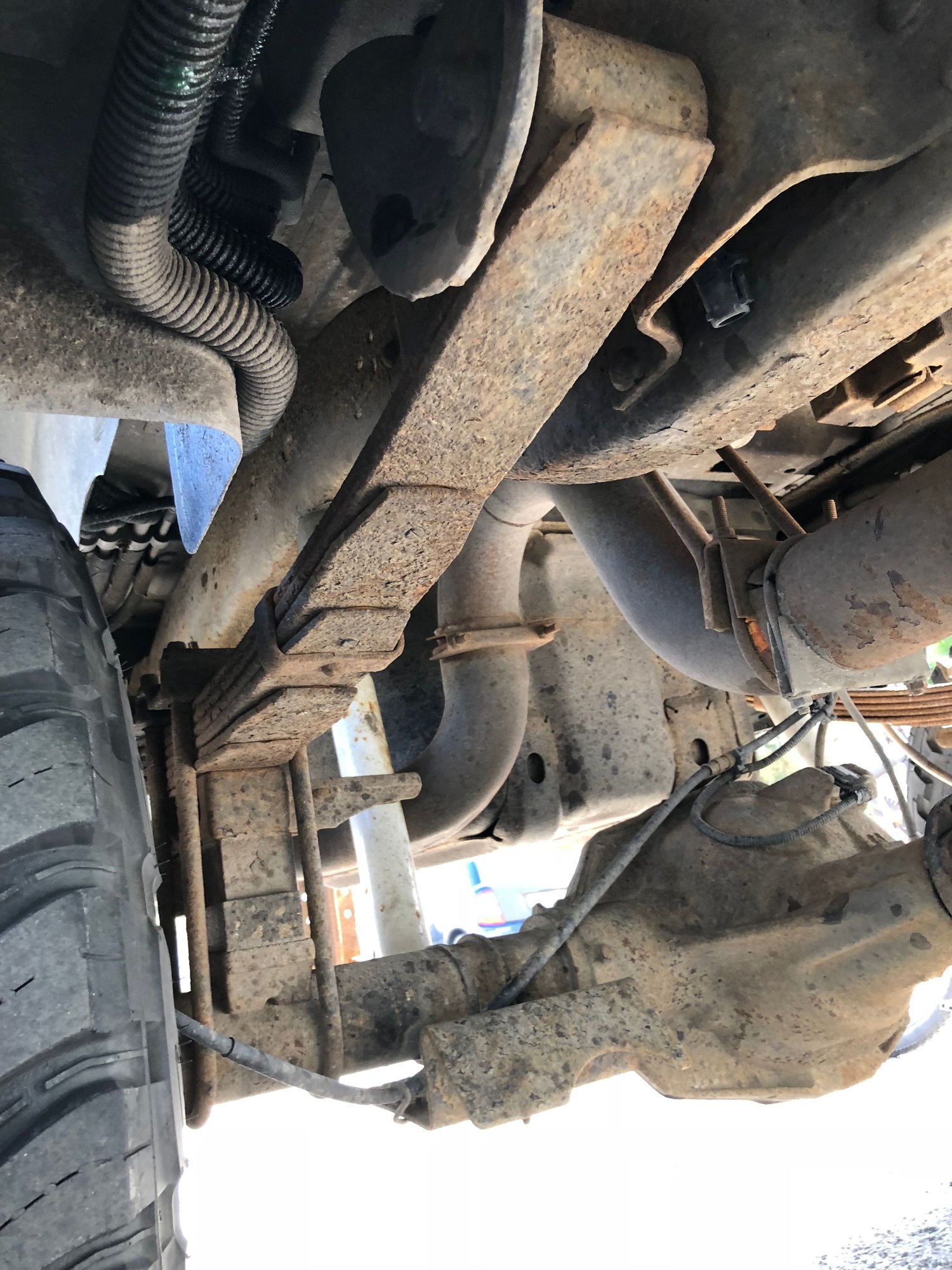

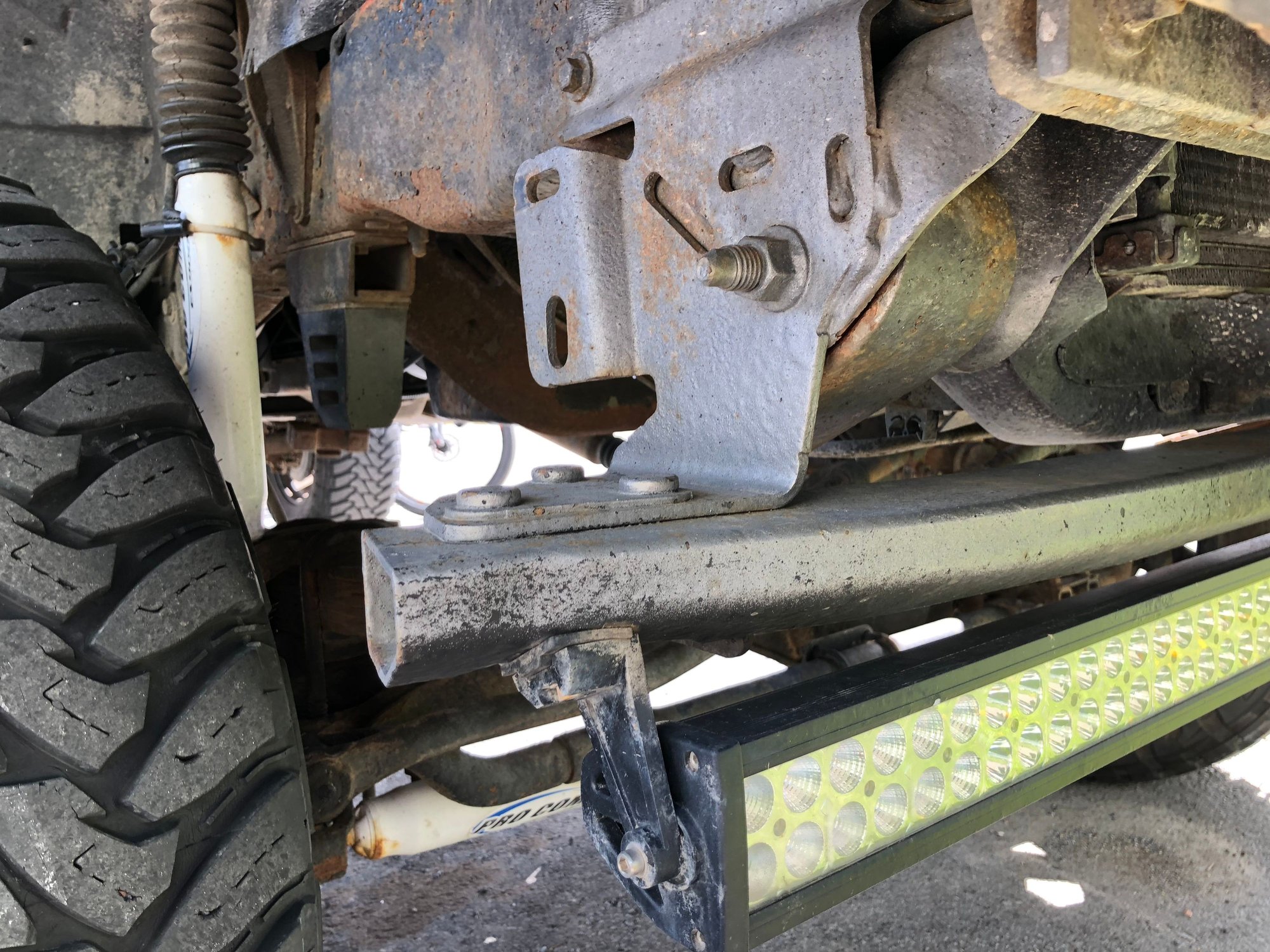

I'll put some explanations with the pics and my question is if this is like a total crap job. I've never towed anything or had anything really heavy in the back. Never really gone offroading either, so while I've owned it hasn't had any stresses on the suspension more than daily driving and the occasional dirt track or simple hill.

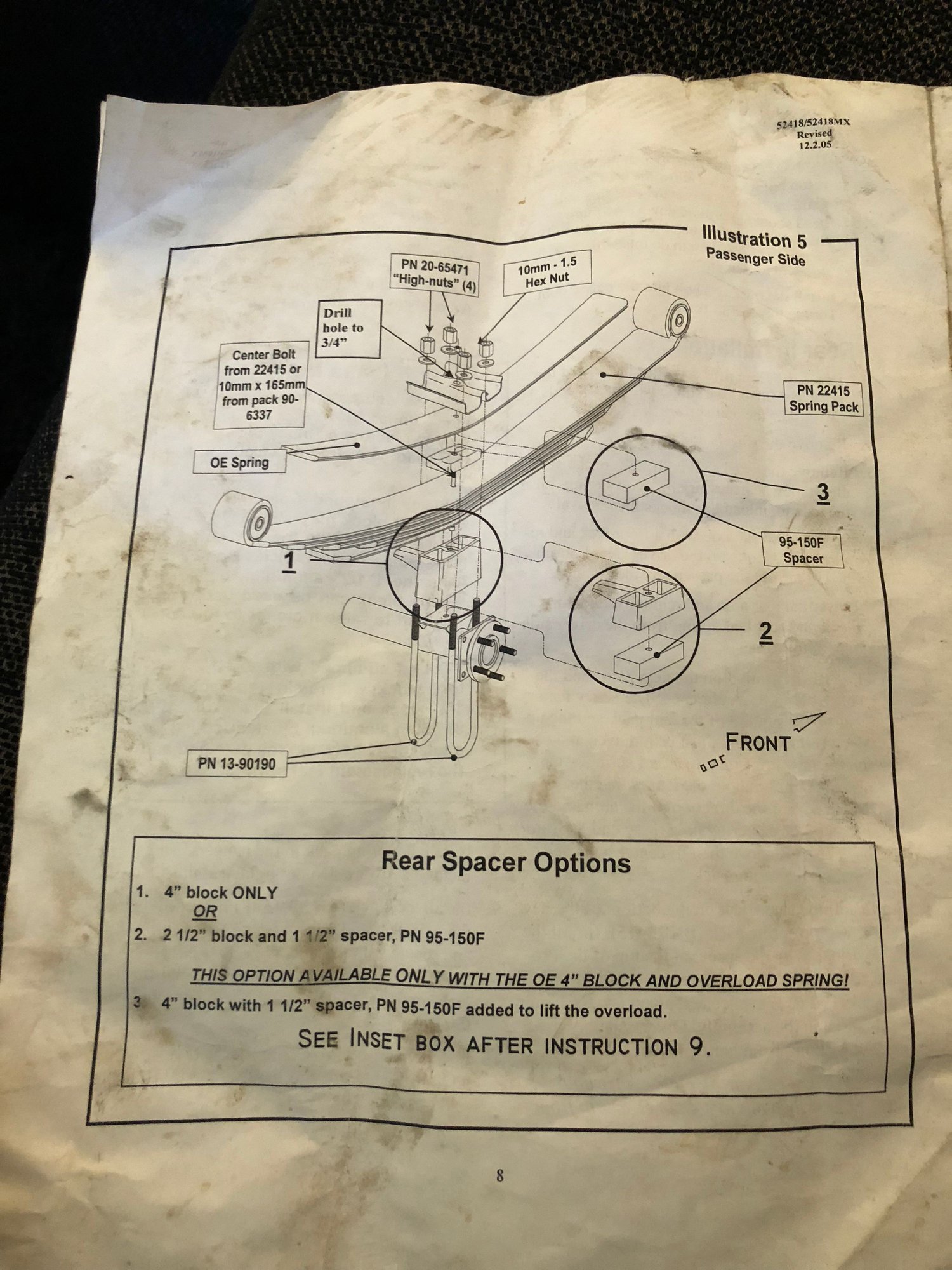

So this is the lift manual I found in the truck after I bought it. The previous owner had no information about when it was lifted or where (back in the states or here in Sweden)
This is the thing that got me confused, about the blocks and what springs are necessary. I measured the blocks to a total of 5,5" which would mean I need an overload spring and while I'm not totally sure what that is I doubt I have it.
From the back
Front mount rear spring passenger side and the blocks, as I said 5,5"
The blocks
Rear mount rear spring passenger side
Front spring passenger side
Rear mount front spring
Front mount front spring

Your spring mounts, front and rear all appear to be factory or at least factory style. Your front springs are full replacements as the factory setup was a 2 leaf spring pack. Not sure if the rears are full replacements or not, but the factory anti-wrap traction bar is not present, it looks like it still has the factory 2"-ish blocks on top of the stack with two additional 2" or so blocks under them.
If you are happy with the current ride height and load handling the springs can stay as they are, i'm not a big fan of stacked blocks and I think replacing all of the stacked short blocks with a new set of properly sized PMF blocks would be a good idea, PMF makes nice stuff.

Yeah I have 4 springs extra that came with the truck, two of them have that traction bar so guessing they’re the OEM rear spring.
So far so good, it rides fine, atleast after I put in new U-joint on rear driveshaft. And since it’s registered as an commercial truck I can’t legally drive above 55 mph. And at those speeds everything feels good.
But yeah, not really a fan of the whole stacking thing, looks sketchy. Hence the plan to get new ones
