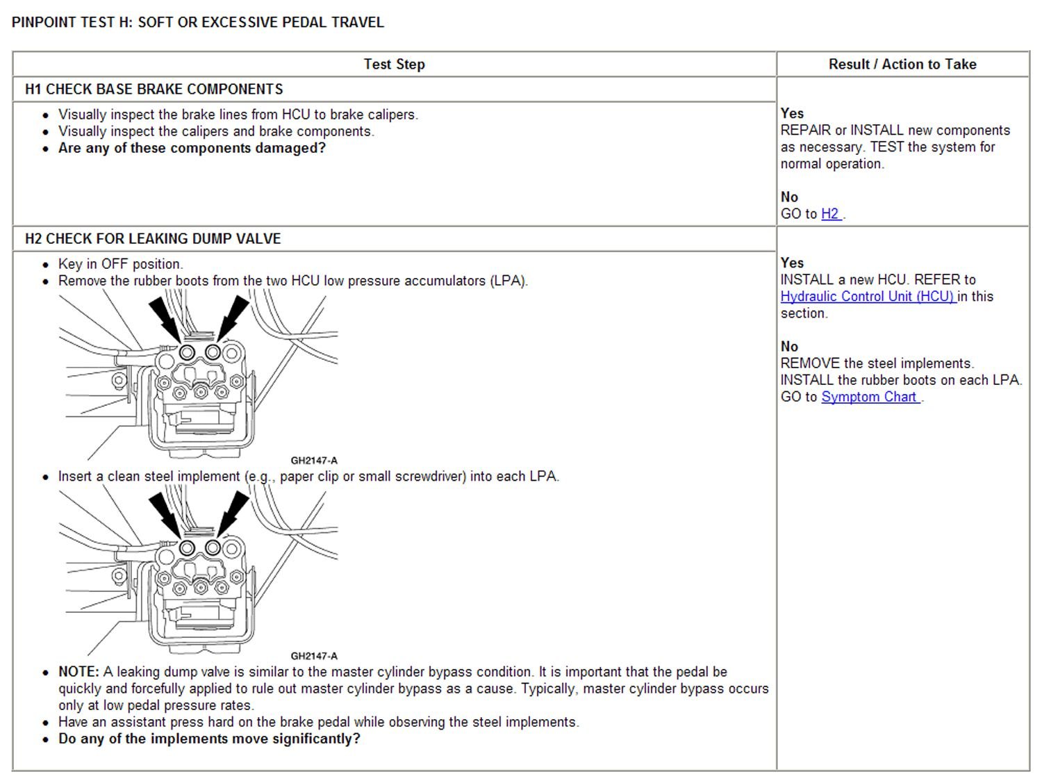

Pads and rotors won't cause an issue like that. Neither will a booster, failed it would be a hard pedal. . Hoses won't have that displacement for what you're describing..
The two most likely issues are either the master cylinder bypassing, or the ABS controller is bypassing internally.
The ABS controller does three things. It either dumps fluid into the internal accumulator to relieve pressure, the pump activates to apply pressure, or the valving dumps some fluid into the accumulator to lower pressure and then prevents additional fluid down stream. That last one is called dynamic proportioning.
Considering all the bad professional advice you've gotten so far, changing the M/C on your own is also the first step I'd go if it was my truck. If that doesn't work then it's most likely the ABS controller. I don't have the service manual for your model year, but the earlier Superdutys had an easy check for the ABS bypassing internally. There was a port on top and all you had to do was pop the plug and stick a wire down the hole to see if there was movement. Probably not the same on yours, but I'll include the procedure for the earlier trucks.

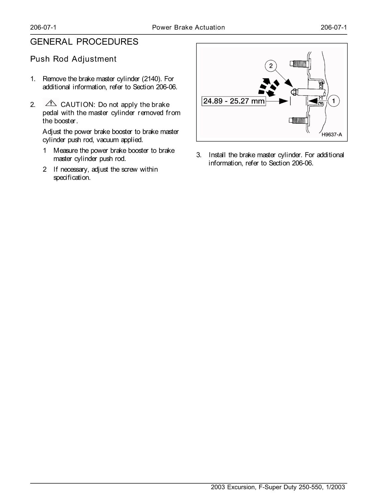

Ford doesnt adjust the booster rod at all from the factory FYI. There are numerous threads in the f150 , super duty, and even e series Van's having poor pressure/low pedal on this site. And every time it's a rod adjustment that cures the problem

It done to the spec at the booster manufacturing plant, and I'm not sure with the SDs if the master comes together at the M/C manufacturer or the Booster manufacturer. It used to come assembled together at the assembly line unless an 18 year memory fails.
The aftermarket master cylinder manufacturers are terrible for holding the piston depth spec, especially with more products coming out of China. My ex-company aftermarket side was one of those and I know there were a good amount of warranty returns that showed that was the issue.
An example of where it should be if the master is being manufactured properly for this model year.

UPDATE Replaced the master cylinder with the new one after bench bleeding it. I then used a vacuum bleeder and then followed up using the two man method. Got all of the air out and have a hard pedal, but there is still to much travel before I get a hard pedal. I looked at maybe adjusting the push rod on the Vacuum booster, but the rod is recessed in the booster it does not stick out like the picture shows. I can get a 7MM socket on the tip of the rod, but no way to hold the rod to adjust it. Is there a special tool for this or do I have the motor running will the rod come out far enough to hold it while Adjusting the head with a socket. Hope someone can help.

Did you have someone press the brake pedal and then try to get to the rod? Does it stick out far enough when the brake pedal is pressed?

No I didn't. I read somewhere not to press the brake pedal with the master cylinder removed. I also read something about running the motor with the master cylinder removed. I would think that there would be a vacuum leak if I did that and the motor would act up. I need someone to chime in that has done this before and to explain how they did it.

OK, again a picture would be helpful. To start with if you look at your master the piston should be flush with the end of the cylinder minus the snap ring that retains it. There should be a shoulder on the master of about 1/2 inch or so to fit into the booster. Measure the distance from the tip of the rod to the opening on the booster and then measure the distance from the bolt boss on the master to the end of the piston. It should be the same.
FWIW, the booster should be hydraulic and starting the truck without the master on will not harm anything. Have you tried to press the pedal with everything installed and checking for end play? That much play should be pretty obvious.
