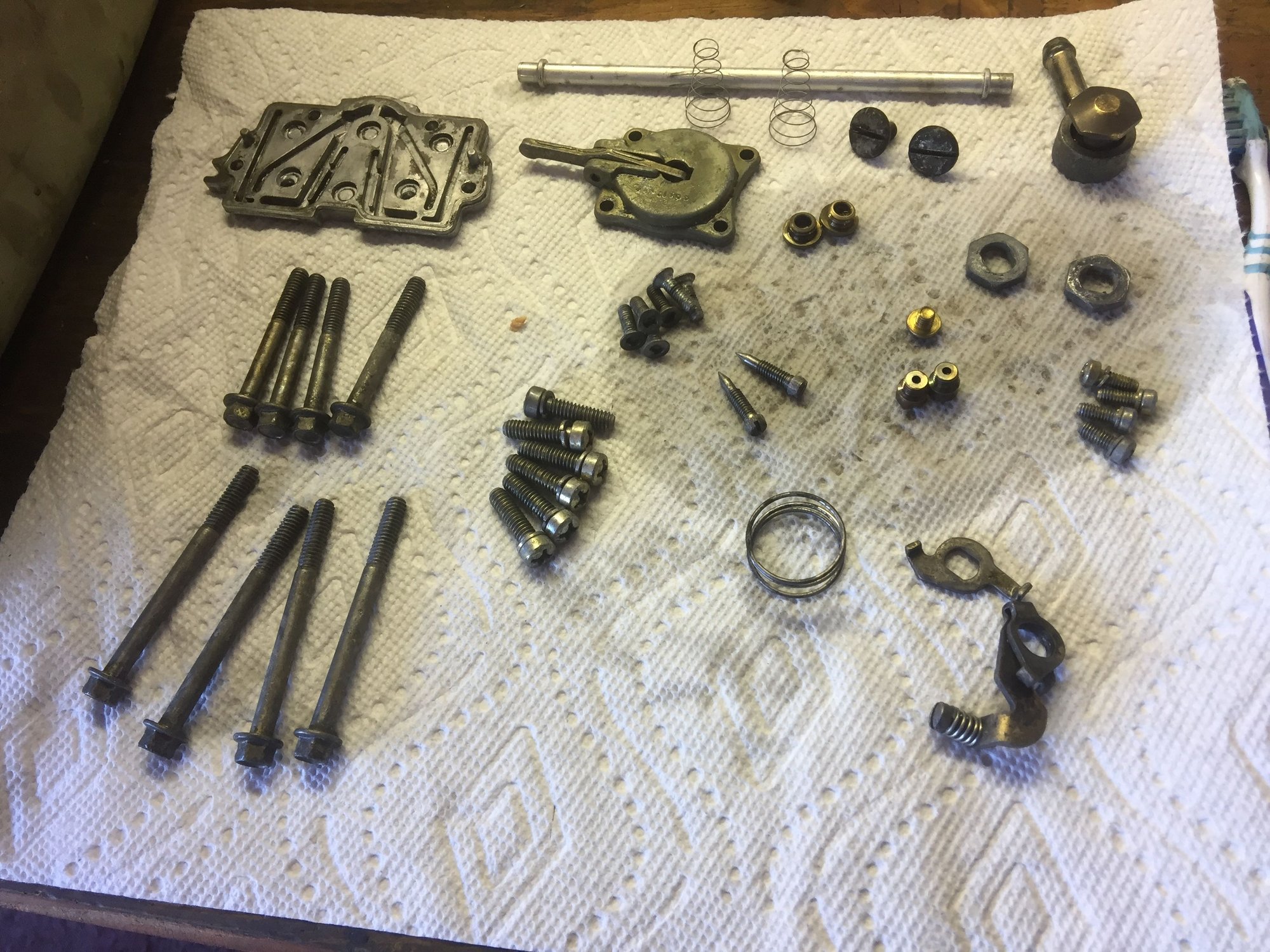

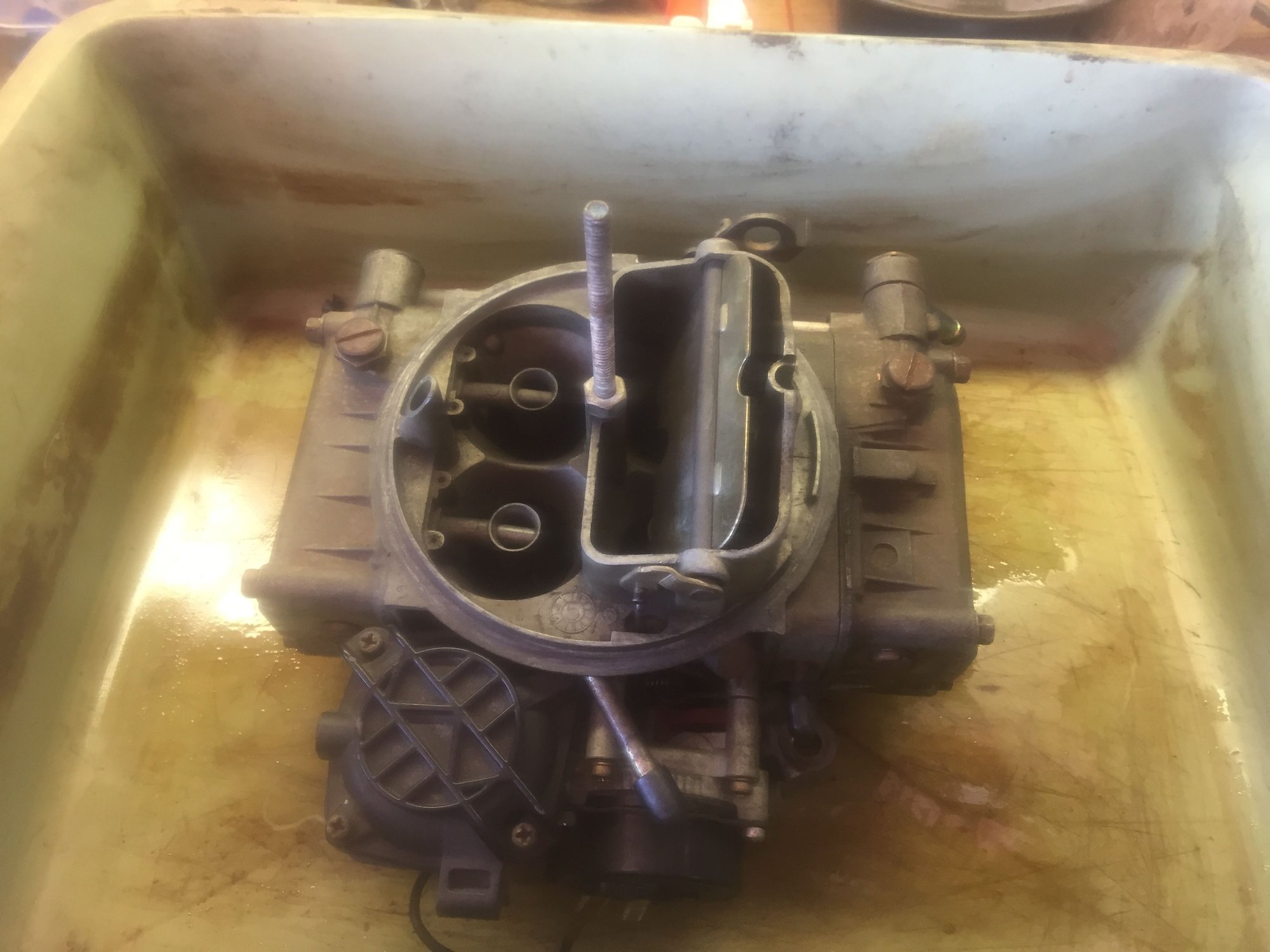

So a few months ago, my oldest son was driving the truck daily, as both of his vehicles were down for various reasons. It got to where it wouldn't hardly run at all around 2000 rpm. He threw a new cap, rotor and wires at it to no change. Since it was rpm dependent, I figured it was in the carb. In the end I found a plugged high speed air bleed. Got it cleaned out enough to run at the time, but then ordered a whole carb kit to go through it properly.
Where I started.
I like to tear carbs apart in a kitty litter pan, that way if anything gets dropped, it can't run away.
I borrowed this ancient ultrasonic cleaner from a friend. It did a really good job with just some dishsoap since I can't get decent carb cleaner here in CA.
Everything came out really clean and nice. I discovered it wasn't so great on gaskets, but there was a bunch of sediment in the bottom of the cleaning tank I had been after to get out.
A friend was waiting to borrow the truck as soon as I got it back together, so no pics and I didn't touch the tune or adjustments on it. I just got it back the night before last.

1970-'72 had a rather unusual choke pull-off arrangement.
How have you handled that with your replacement carb?

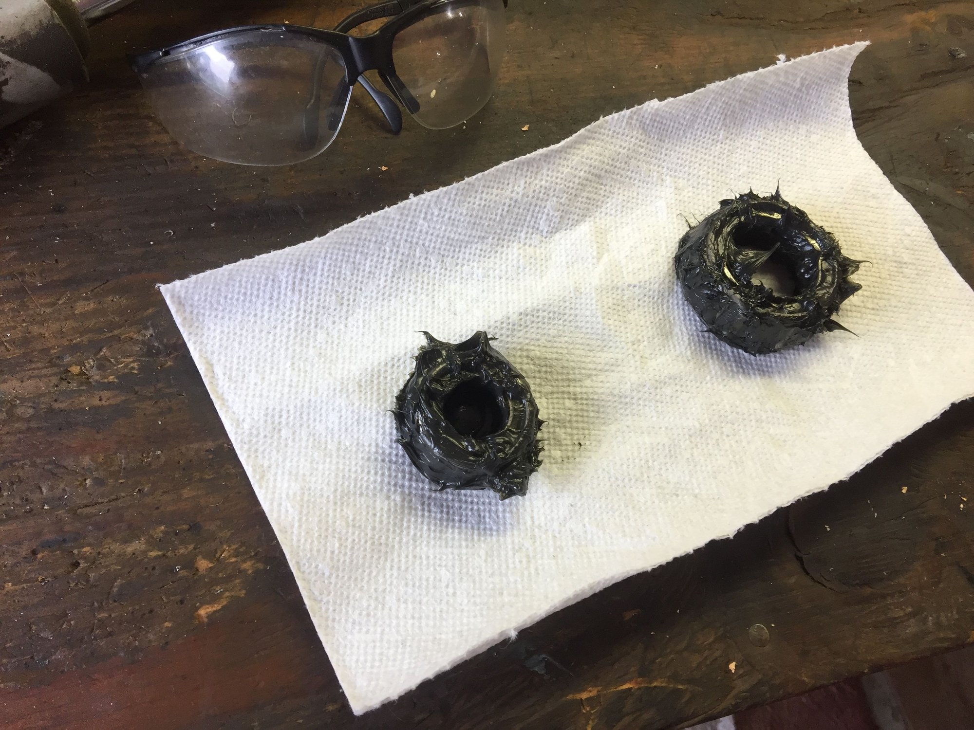

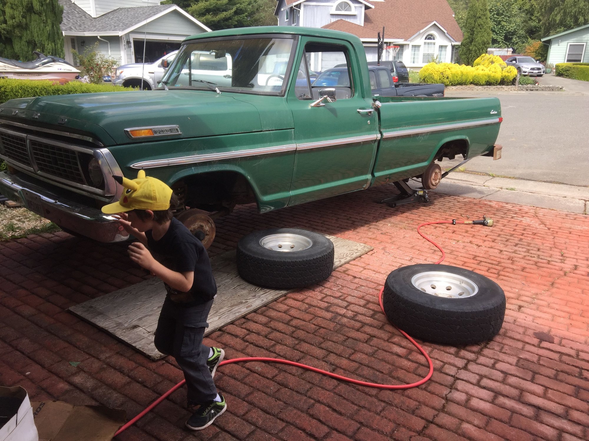

So it's been exhibiting a problem from the left front, yesterday I took some time to look into it.
With the help of my youngest, I swapped the tires front to back. Knowing that the tires are old I was hoping that was the problem. Nope, no change.

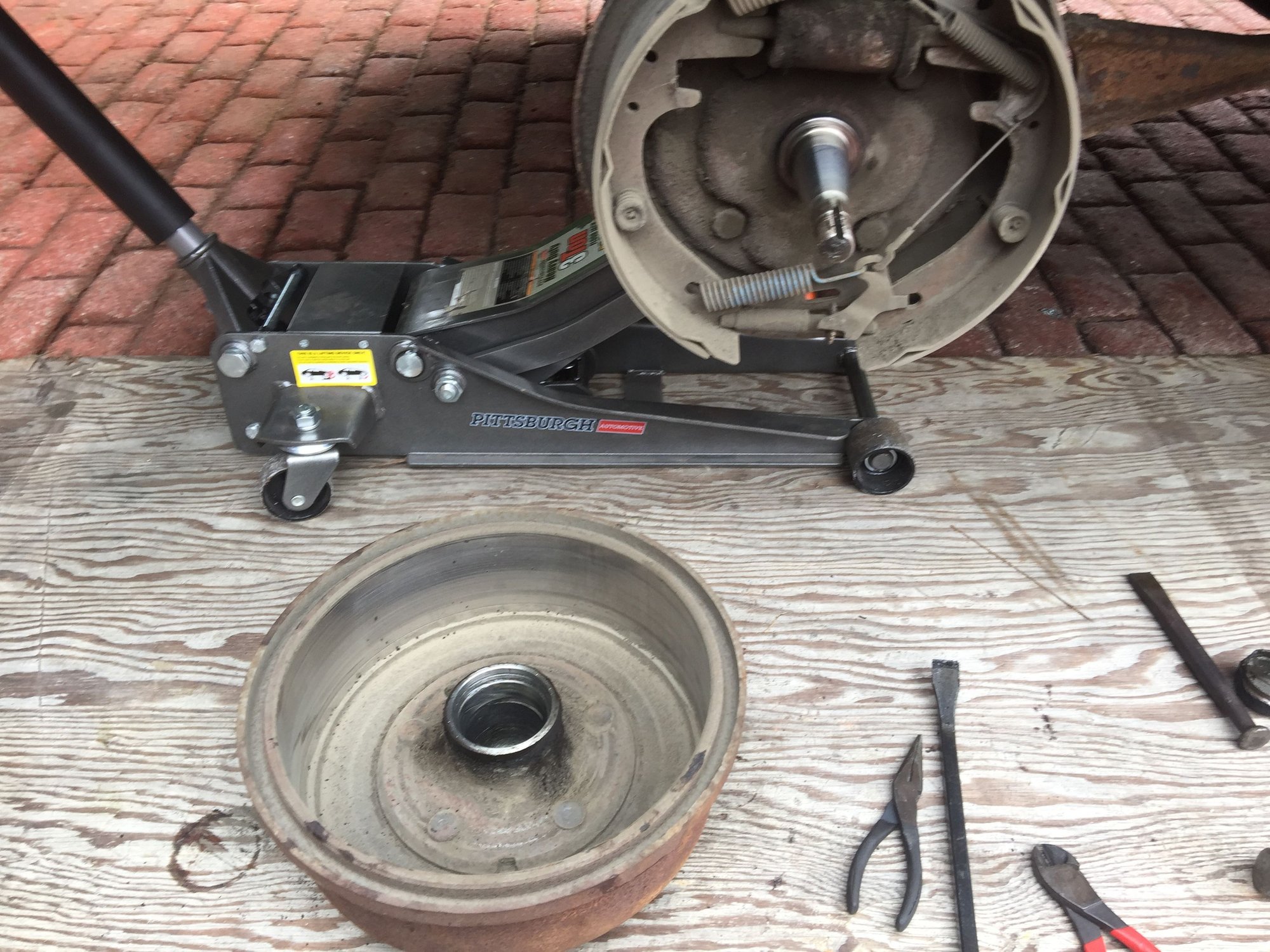

Next I pulled the drum off, removed, cleaned and packed the wheel bearing. No signs of abnormal wear or metal shards. Test drove again, no change. But in paying attention, I noticed that it doesn't pull while braking. I almost always use compression braking so I hadn't picked up on that before. At this point I'm thinking I likely have a failed brake hose keeping pressure on that wheel. So far as I can tell all 3 soft hoses are original. Replacing them is now on my to-do list once I have a few more duckets to throw at it.
Devin

I see that the wheel cylinder is leaking, if you roll back the dust cap you'll have a lot of fluid their that's the rubber cap on each end of the cylinders. .
Take a better look at how the out side of the wheel cyl has leak an brake dust has attached to it...
A wheel cyl with a frozen piston can cause it to drag.
when replacing your you must do both front not just one wheel must do in pairs...
Orich

OP, I think while you have the brake system apart you have a good idea in changing all three brake hoses. They aren't exactly spring chickens. Let all the brake fluid drain from the M/C. Take a clean rag and wipe all the sediment off the floor of the M/C.. Once you're ready to bleed the system fill the M/C full of fresh DOT 3 brake fluid out of a brand new bottle. While bleeding watch the fluid level and don't let the M/C go dry.

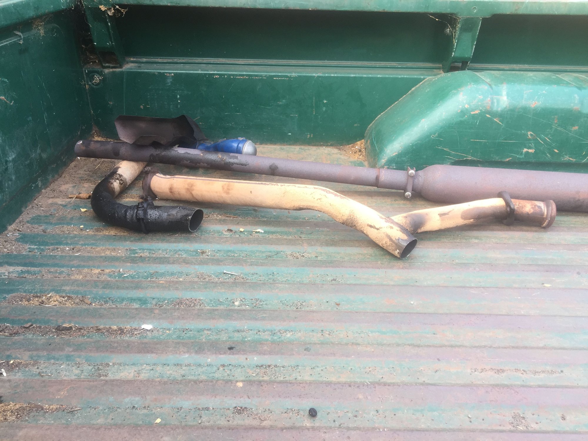

However, as I believe I mentioned previously, this thing needs exhaust. There was no muffler whatsoever on the passenger side, and a cherry bomb on the driver's that dumped under the bed. I had been putting off doing anything about it since I wanted to do headers at the same time. A while back I bought a kit to do headers and full exhaust from Summit. Today I was able to start disassembly.
The pipes came apart easy enough with a Sawzall, but the manifolds are another story. I broke 3 studs on the driver's side and all 4 across the top on the passenger side. Ran out of time and didn't get to the bottom row. This is going to be fun to get them out.
