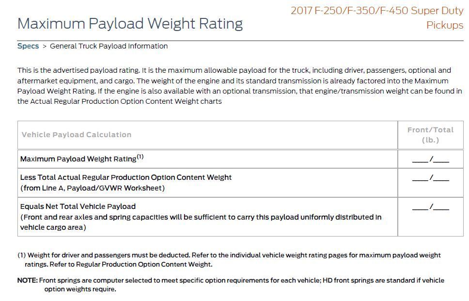

Exclamation
Originally Posted by Blwnsmoke
payload = full tank of fuel and 1 150lb driver.
Ford's definition appears to be different:
The curb weight does include a full tank of fuel.
HTH,
Jim / crewzer
HTH,
Jim / crewzer
Interesting, everything I have ever read said the driver was included but then again, it is the internet.

It’s possible that the payload driver weight allowance notion is a misplaced carryover from old maximum trailer weight ratings which did include a 150 lbs. allowance for the driver. Ford’s modern maximum trailer weight ratings for the F150 and Superduy allow for 300 lbs. for the driver and a passenger.
So, I occasionally wonder how old I was when I permanently passed 150 lbs. I do know it was WELL before I earned my DL.
