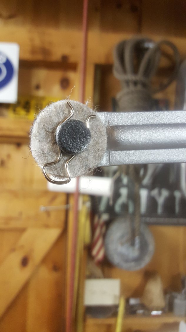

I just painted my window regulators yesterday with some silver paint I had left over although I masked off the gear and spring. I also made some new felt washers from leftover upholstery padding and retainer clips from the handles of some small binder clips. I'm not sure if the felts will hold up and I don't think the clips are tight enough. Does anyone know a source for the felts and clips?

If it is pretty rusty and won’t clean up use Eastwood Rust Converter. Then you can paint it a light color like the silver that Dan used that makes it much easier to see if on reassembly.

Restoration specialties has the clips, not sure about the felt.

I found the clips in their catalog and they also have the original style hose clamps that I've been looking for. Still looking for a source for the felt washers.
