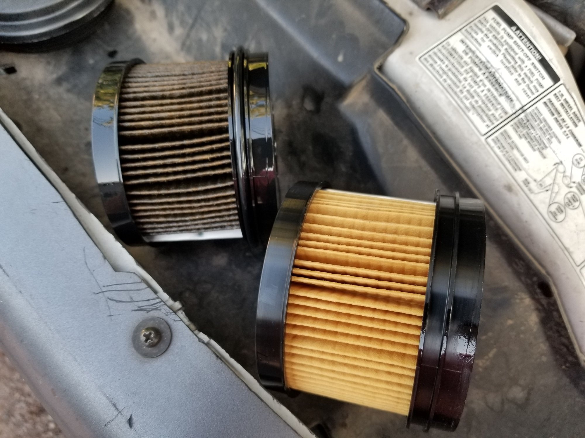

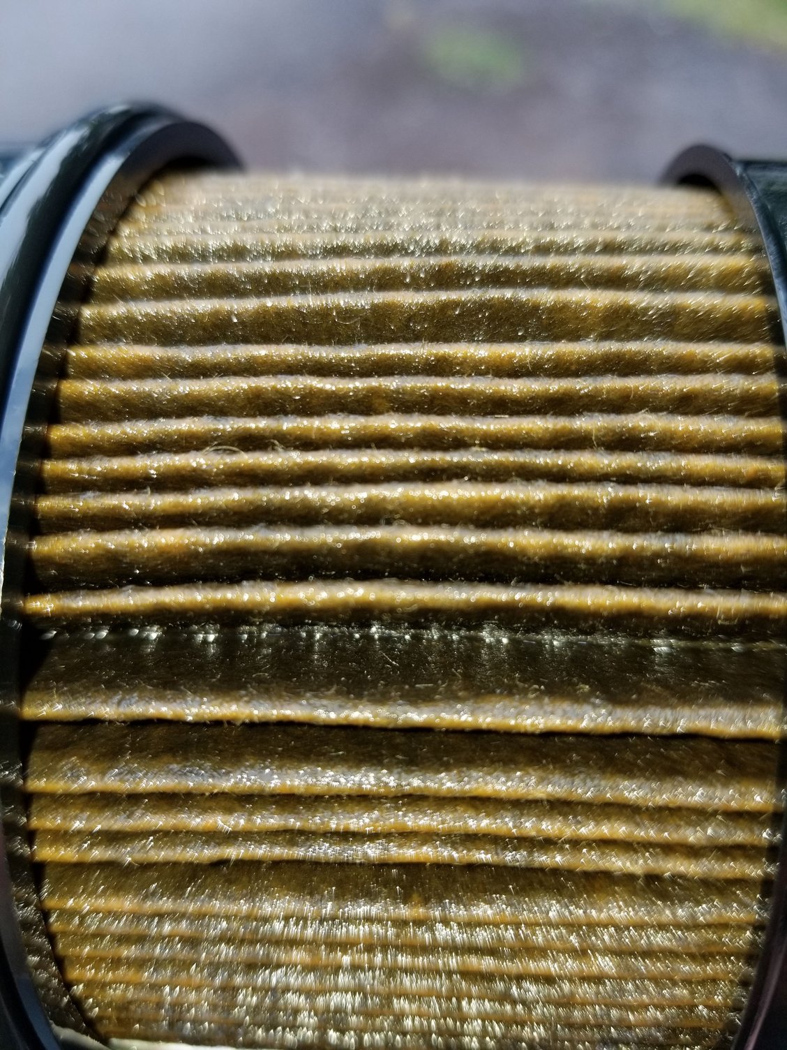

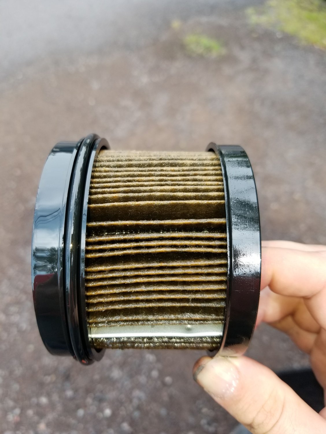

Got a new filter. Here it is side by side with the old filter for comparison - the old one was beyond gross. Both are the same NAPA filter. It still has the knock but it's significantly quieter, and the idle is much smoother.

The last time mine started knocking like that I tightened the lower hold-down bolts and things quieted down (all of them were loose).
Is that oil on the filter?
Random fatalist theory: Loose injector (knocking) that has damaged an o-ring allowing HPO into the fuel system.

It's technically 2-D Fuel Oil (Clear, ULSD) so I guess it's oil It's just horrifically dirty - if you zoom in you can actually see algae on the filter, which would be "biomass" that has separated from biodiesel. It happens nearly every winter with biodiesel, and the truck was originally registered in Minnesota which decided that B10 to B20 would be an awesome requirement for all fuel sold in the state in the summer, and even required B5 biodiesel in the winter (It DID NOT work well when they first implemented it, we had truck after truck with clogged up fuel filters - it was so bad that the company I work for stopped buying fuel in the entire state during the winter months). Supposedly, Minnesota has worked out the B5 winter biodiesel performance problem, and they even made a website swearing up and down that it was never a problem, but they're full of you know what
I have no problem with biodiesel in the summer months, it helps replace the lubricity lost when LSD switched to ULSD, but in the winter months in a state which has seen temperatures below 50 below zero in the winter, you have to use some common sense.
The bowl was clean and didn't show a single trace of dirty oil on it, there is some minor seepage around the EBPV rod but nothing unexpected after 20 years of using a piston.
