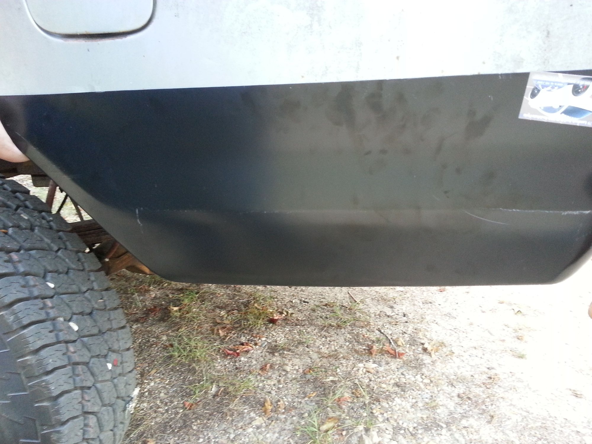

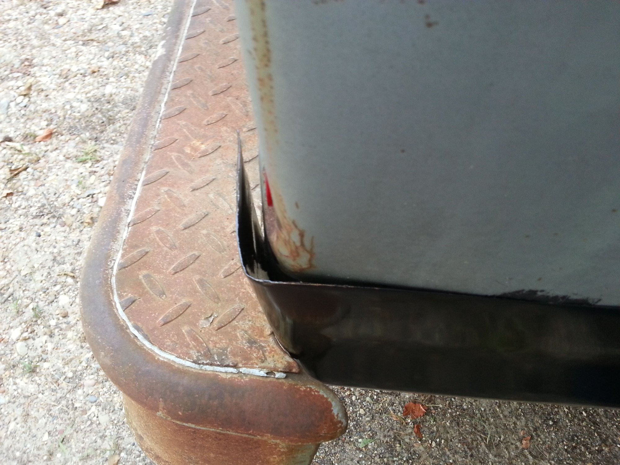

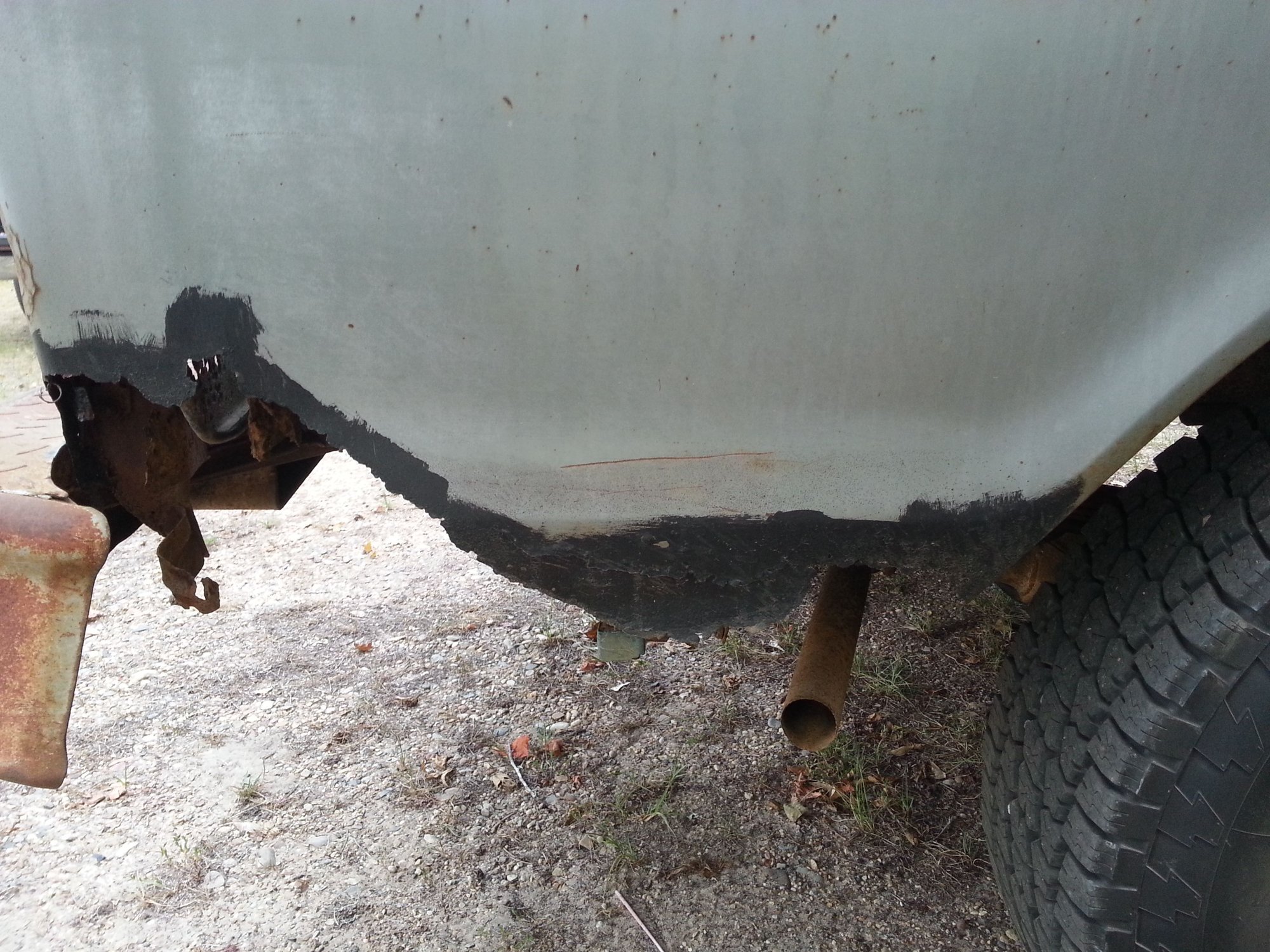

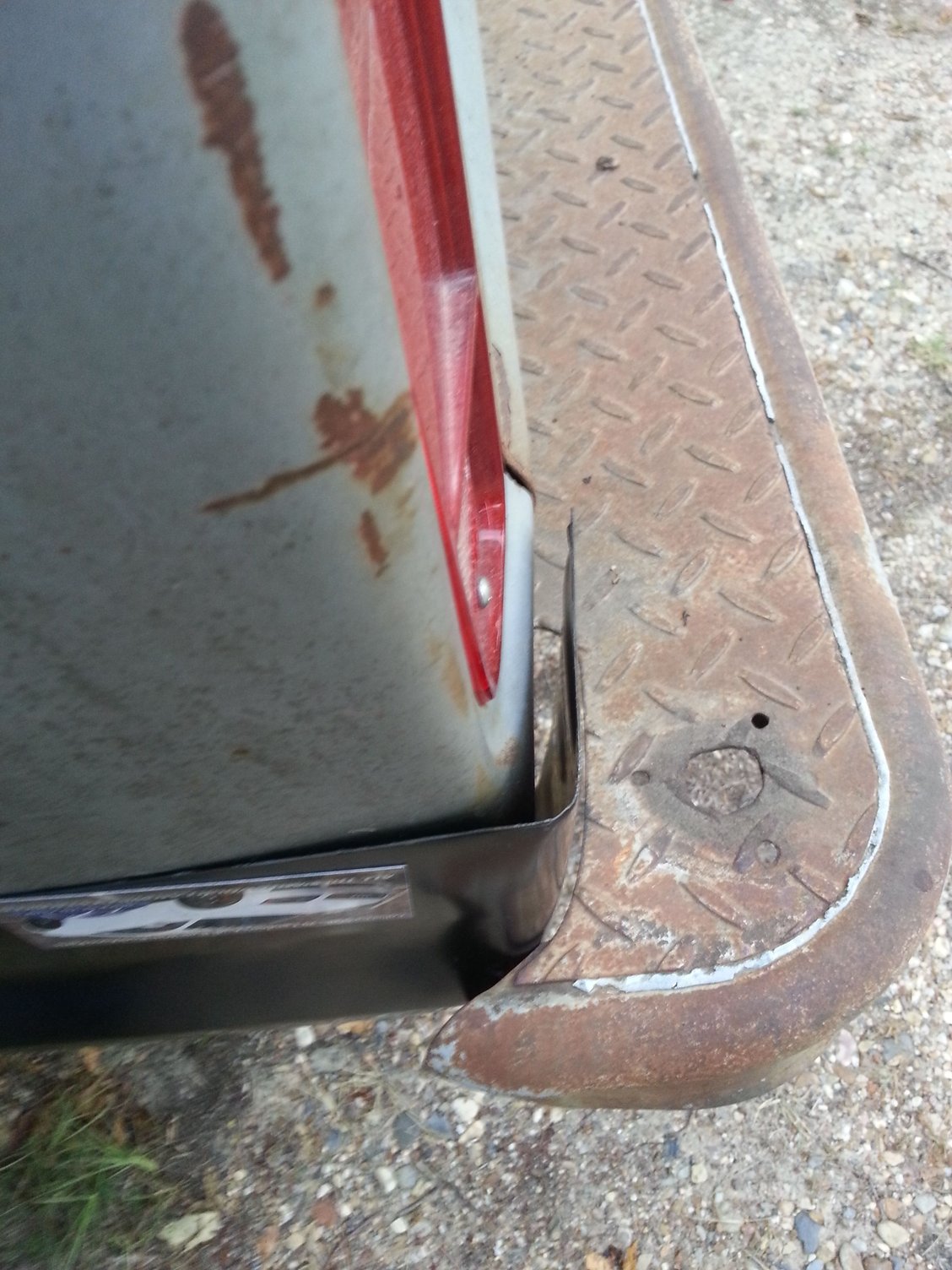

I cannot find patch panels for a short bed, so I got some for a long bed figuring I would trim them down. The ones for the rear are almost a perfect fit. It appears there will be about 1/2" gap as you can see in the photos.
My question is: Should I try to trim the difference from the patch panel? or Is there a way to "shrink" the patch panel? If anyone had done this before and can offer advice, thanks in advance.
Drivers side cancer. Treated.
Drivers side patch
Gap between old and new.
My plan is to keep the radius at the wheel well and trim some towards the rear.
The same on passenger side.
Passenger side cancer.
About the same gap on passenger side.

After market panels always need some cutting some massaging into proper fitment , its never easy , and some may never line up perfect and then you have to get creative , I would cut out the old rust an area that your patching, and test fit again but if you cant make it fit as needed you may have to split patch panel in half as last resort and move pieces closer in an have an extra seam to deal with its always different with any patch panel I have used , getting more of the old metal cut out may help with fitment but you will have to trim on the new panel somewhere ,,hopefully there will be more replies with better ideas as I am no expert but have done many an its always a fight for proper fitment

On a dent I believe the extra long box length is all before the axle. I think you're just dealing with poor panel fit.

I would also say poor panel fitment.
