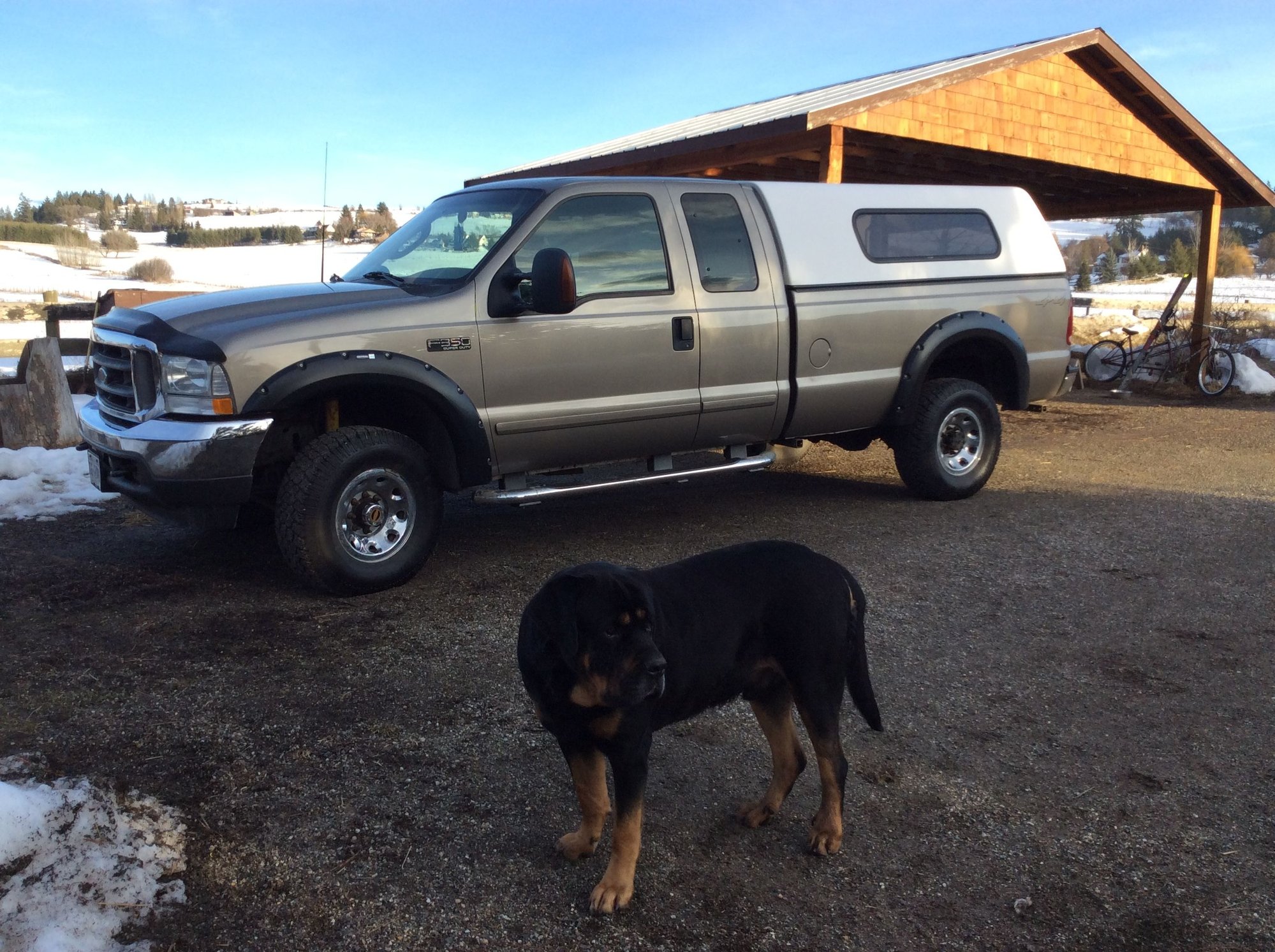

I've owned a 2003 f350 with the 5.4 for eleven years now and it's just turning over 300,000 kilometres. It's pulled campers, boats, horse trailers, flat decks, etc etc etc. Synthetic oil in it always and I've only done plugs, filters, brakes, and one fuel, pump. I have flogged that truck ridiculously hard over and over and over again. So I can't help but just laugh at some of these comments. Original drivetrain entirely. Nothing has been or needed repair. Motor, tranny, transfer case and both diffs all original.
