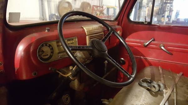

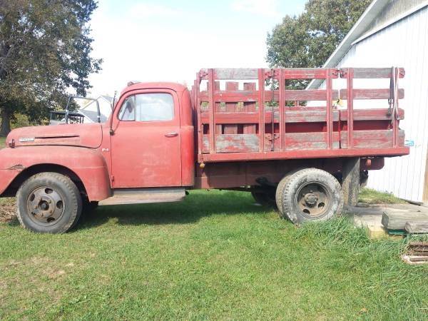

my new toy. Purchased from the nephew of the original owner, been on the family farm since 48. V8,4speed,original widow makers, Ford script bed

Very nice. Looks solid.

Welcome. Great looking truck. Glad you’ve done some reading and know about the widow maker issues. When you’re ready to think about replacements you might do some Google searches for 19.5” tubeless Budd #89340 wheels and 8R19.5” tires. They are ideal F-4 replacements. Stu

Absolutely a great truck you have there.....truck dog is correct ...the first thing I did was find wheel replacements ..... 19.5 one piece budd wheels......good luck keep us posted....

Welcome to FTE the best Ford truck Forum on the world wide web! Thanks for the pics. Nice truck and it still has the racks in good condition.

Welcome to the forum. That is an amazing find, Beautiful That one deserves to be preserved.

I just scored wheels and tires off a Dodge motorhome. Anybody want some widowmakers?

Hey, hey! Outstanding. You should find that Budd #89340 on the concave side, unless yours are the earlier version #72070. Send those widow makers off to China. Stu

Yeah, what truckdog said. Those 18' widowmakers don't even make good fire rings.
