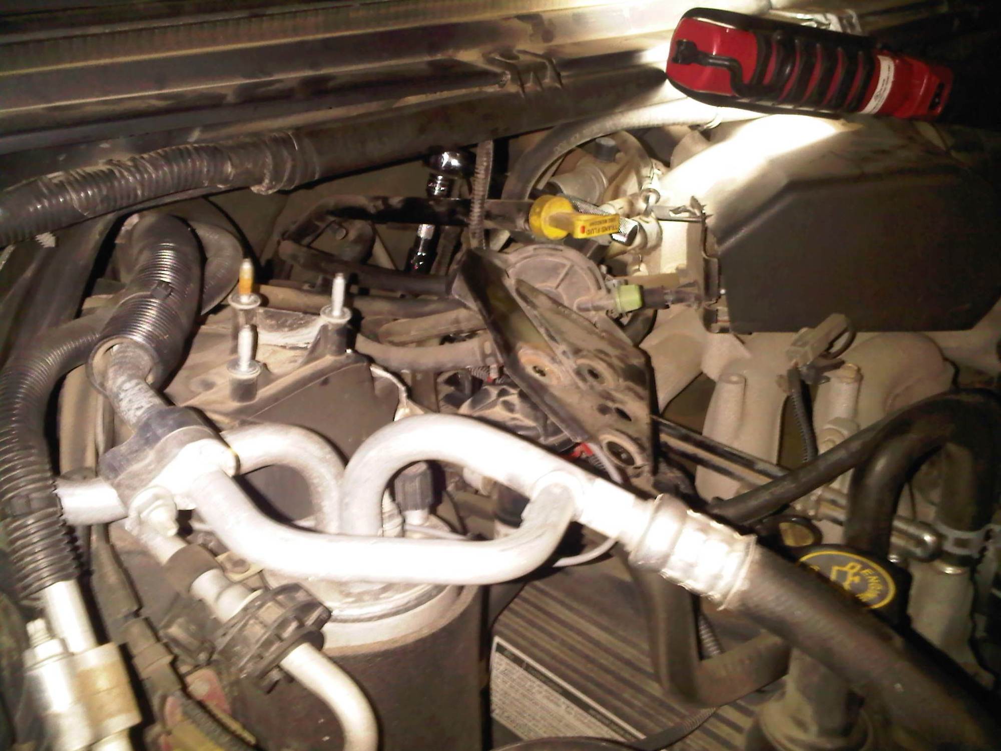

Plus no need to over tighten those coil bolts, they don’t need to be on there super tight. Agree #5 is a pain, but not too bad if you remove some hoses and the triangular plate held by 3 nuts. Dirty hands go with that job.
