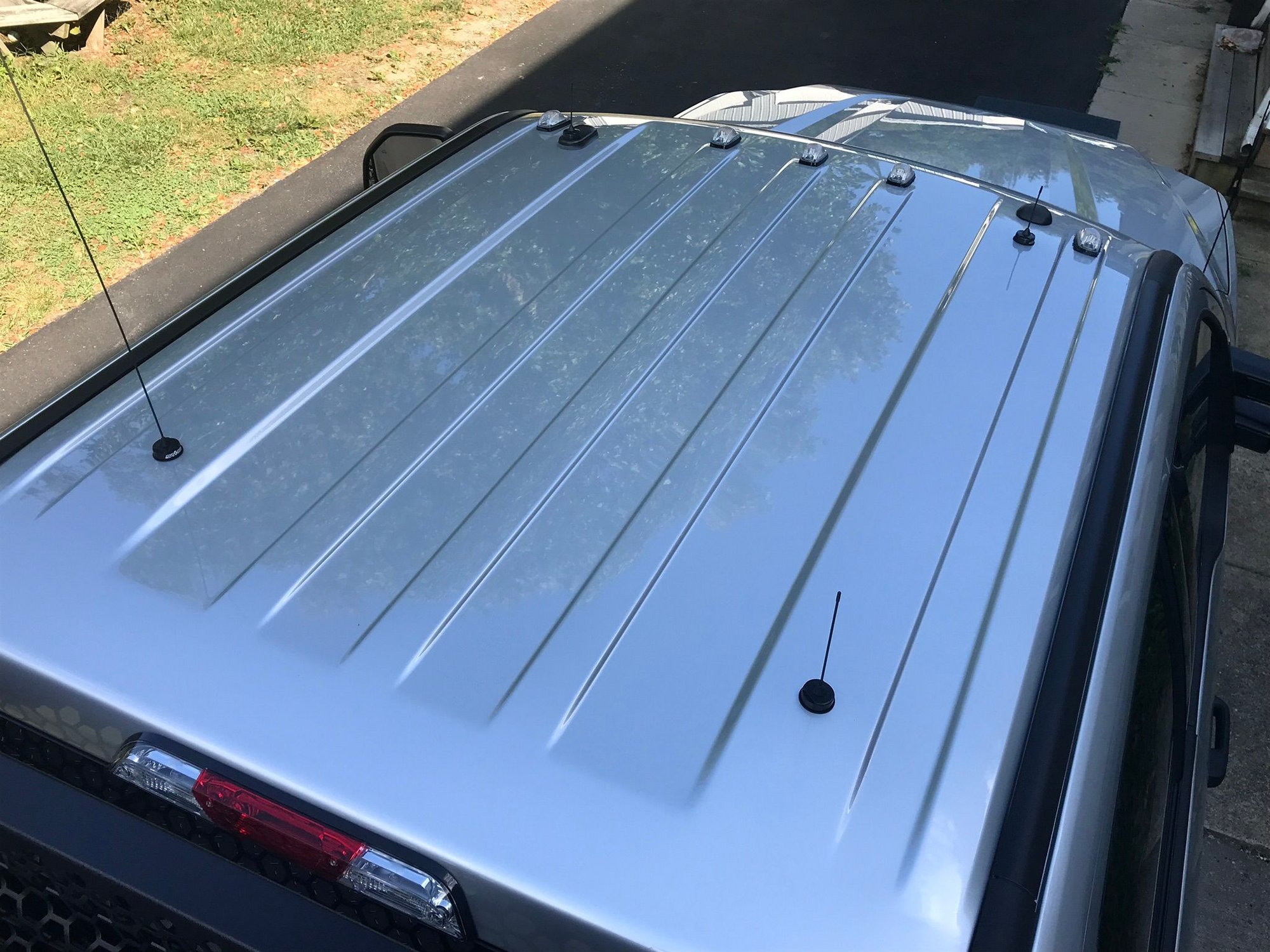

Yes, totally dropped and replaced my headliner as part of several projects (upfitter switches, cab lights, and 4 NMO antenna mounts).
Yes, for the front area you should be able to get access to what you need by just dropping the visors and A pillars. Where on the roof do you plan on mounting the antenna? What type of mount does it use? If using an NMO Mount I would not be concerned about corrosion. These are usually brass and sealed quite well. Unless there is moisture getting to where there is metal to metal contact corrosion is not an issue. I have been installing NMO mounts on Aluminum paneled vehicles for a long time. Crown Vic’s had Aluminum trunk lids for 20+ years ago and no one ever had issues with galvanic corrosion.

I do have a picture of the exterior
