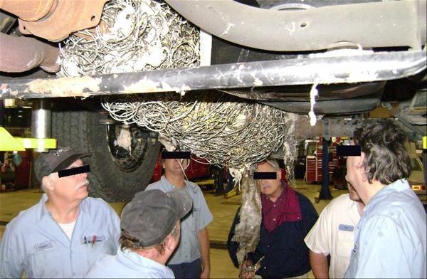

And make sure there's no mattress wrapped around your drive shaft:

I just spit a mouthful of spaghetti out. OMG that is HILARIOUS!!!!!!
Now my dogs are happy.....spaghetti treats
