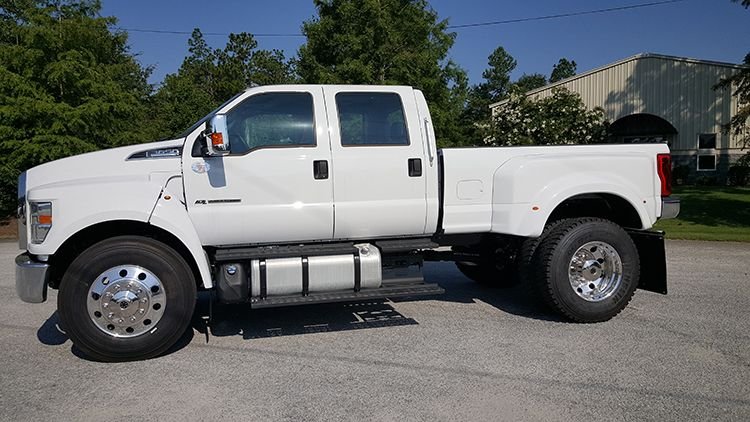

How about one of these? You’d just need a couple of extra steps for the camper!

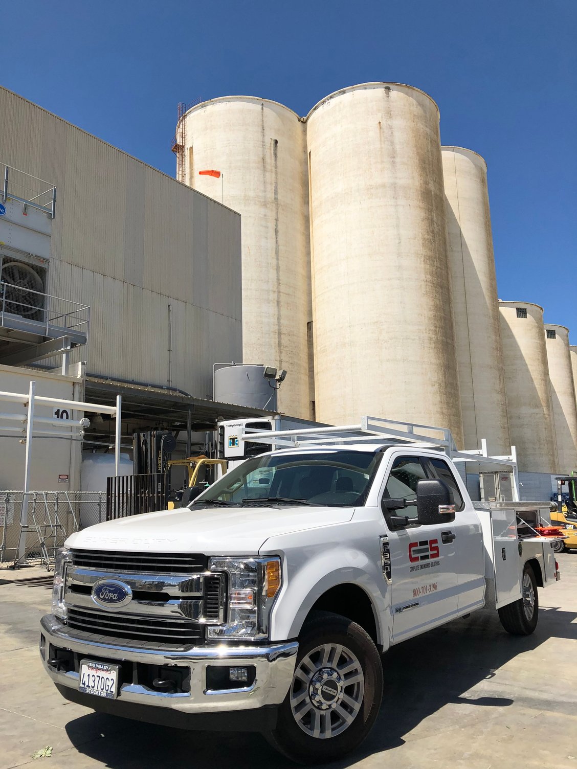

I have a ‘17 F-350 XLT Supercab SRW. I have the full power 6.7. I specified That I wanted the full powered engine. The engine vin code for a ‘17 at full power is a “T”.

Nope, it was a chassis cab. Service body installed by local supplier.

Ordered the truck with the full powered engine, xlt trim package. Front buckets with the large center console. Sync 3, upfitters, powerscope mirrors. Average weight sitting around 9300lb with all my tools on. Average mpg has been about 15.4. Picked it up in November of 17 and I have a little over 32,000 miles on her.

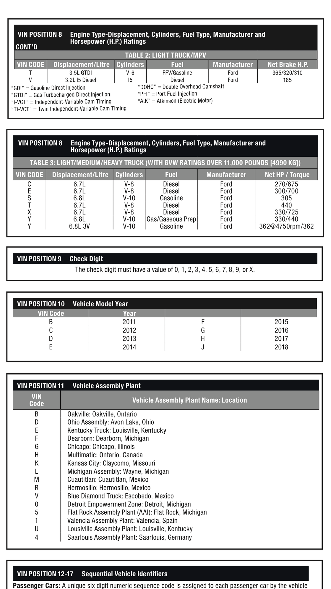

I have to disagree, VIN positions 5-7 are X3A. Which is an F350-4x2-SuperCab Truck/Incomplete Vehicle. And position 8 on my VIN is a T. On the ‘17 ford vin breakdown guide from ford they don’t list any of the trucks as chassis cabs. They are all referred to as IV (incomplete vehicle). Granted, this vin guide is my only source for this info.

I may have to retract my previous statement. X3E shows the same load out with only “IV” listed. So that one, I would assume, is a chassis cab. Makes me wonder too because my rear suspension does seem awfully weak. Would make sense if I have a standard pickup chassis. Anyone know dimensional checks on the frame where I can confirm if I have a standard frame or chassis cab frame? Wanted to install some airlift springs in the back but didn’t because they said it would not fit a chassis cab frame, but if I have a standard frame....😏
