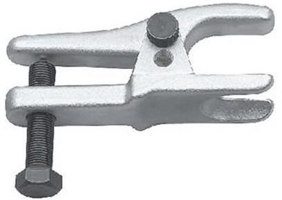

I changed our Excursion tie rod ends with this separator which worked great.
I like it better than the forks I have used.
I have also used just a hammer, but be sure to remove the nut first or position it at the end of the threads.
If the the threaded end gets mushroomed from hammer blows the nut may not come off.
