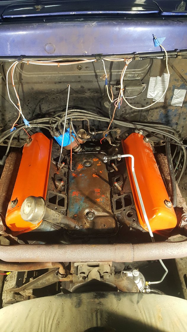

Need to replace the valley cover on 292 Y. Was referred to John Mummert, but get no reply. Any other recs ?

No 292's until 1957. There's more than one type of these covers.

Engine is a 59'

Hwy lostbyd, may I ask for what reason you need a valley pan, oil leak? or to just replace with later model in the sixties to add on a PCV valve. There are several on Ebay, but for 55 through 59 or so, without the breather hole. I have found two recently on Ebay for the later model with the breather hole. if yours is just leaking, bent . With a kin eye you can take a pair of channel locks and straighten the sides. Some get bent or bowed. Just takes some patients, and time to straighten.

Originally Posted by lostbrd
Engine is a '59
B6A-6519-A .. Valve Push Rod Cover / 7.32" wide with 9.06" overall length filler tube / Obsolete
F100/700: 1954/59 239/256/272; 1957/59 292 // 1954/59 Ford/Merc Passenger Cars 239/272/292/312.
No Ford dealer or obsolete parts vendor has any.
