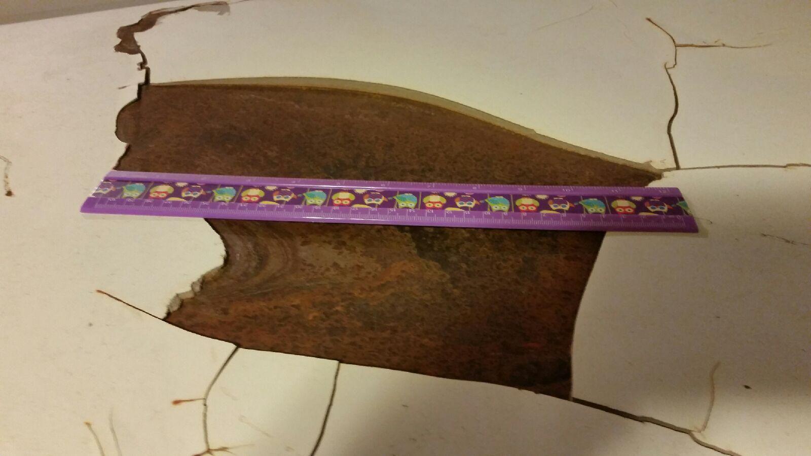

Bought this regular cab pickup.
Knew it had this issue on the surface of the roof, but did not realize how bad it was.
Even if I did know the extent, I still would have bought this.
I would like to know what the best approach to patch this would be.

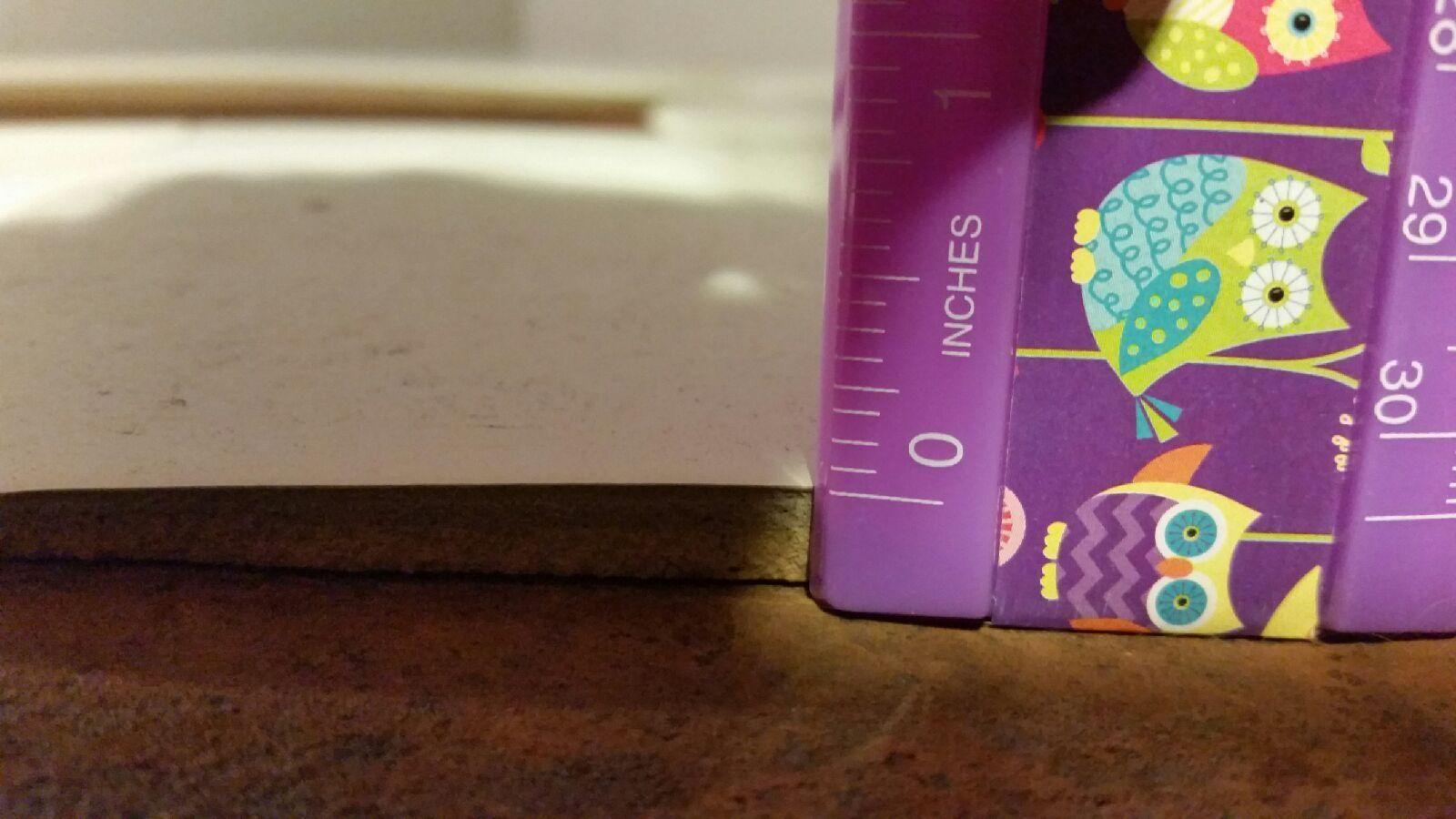

I am not wanting show room quality, I just don't want water to get through and pool underneath the (future) paint (job).
A friend that has done some restorations before speculated that a former owner dropped something on the roof and patched it with something, and that I'm seeing the age of that patch failing.
The drip channel above the doors and about about three inches in from the edge all the way around the roof looks good, no cracks.
It was in the desert, so the rust that is visible in the photos is just on the surface, so far as I have found.
Any ideas of how to patch this?
One thought I have had is to spray a light coat of rust reformer, then bondo it.
I realize the center of these two voids exceed the thickness of what bondo is made for, but my thinking is this is a horizontal surface.

That's a TON of bondo, you would be better starting with a new cab, a lot less work.

Whoa! That's ridiculous. Any filler used that thick will eventually fail just like that. You gotta first push it out as much as possible. If there are no hard creases in the roof panel, it'll probably push out fairly easy. Pull the headliner and look for bent roof supports, if there are any, push those up. I'd use a bottle jack and length of 2x4 with a short length across the end like a "T". Hammer on any bends you can see while jacking to relieve stress. Be careful not to hit the roof panel or you'll put dents in it, hit the supports. I'd be willing to bet it'll mostly come out with that. If there's no support in the middle, push it up by hand in the middle of the dent and have someone go around the dents outside edges lightly tapping with a softer rubber mallet. Either way, should be able to get it pushed out close to stock. Once you get it close, sand the outside clean, wash it with something like lacquer thinner or acetone. Let that fully evaporate, then spread filler, if it needs it. I don't like more than a skim to even things out, the thicker it gets, the more prone to fail. Smooth it out, prime, block sand, prime and block sand again If needed, seal, paint. If it's not a show truck, I'd take a slightly wavy roof over filler up there, but that's me.
100% agree. Every time I wash my truck or when I was polishing the oxidation off, that roof section warps and pops in pretty easily. It pops right back out once you take the tension off, but the warping could easily crack any bondo you put up there and you will be right back where you are now. Maybe around the outer edges where it doesn't warp as much, but definitely avoid the center of the roof if you can. If not, be careful washing and waxing up there.

I unscrewed the headliner on both sides. Driver's side and roof support are fine. Passenger side has an L shaped tear that has been welded or soldered back together... it looks like whoever did it just wanted it not to leak.
I am going to live with it for now and try bondo'ing it. Worry about replacing the cab later.

did you push the outer roof panel back up into shape?
If so how far from the inside cross brace is the roof panel?
Something is not right if they had to add that much bondo to the roof.
BTW if there are no cracks in the metal roof it will not leak. What will happen water & dirt will get between bondo and metal roof and rust a hole in it and leak.
Push everything back up into place. Removing that old bond will help with that.
Once in place and old bond removed treat the rust, thin coat of bond and fish it with paint.
I have not tried pushing on it yet.
The roof over the cross brace is in the original shape that I could see.
The dent/tear seems to be more over the passenger side.
That is my thought, that I want to seal as good as possible to prevent it pooling underneath the paint.
At least long enough to decide what I want to do with it.
