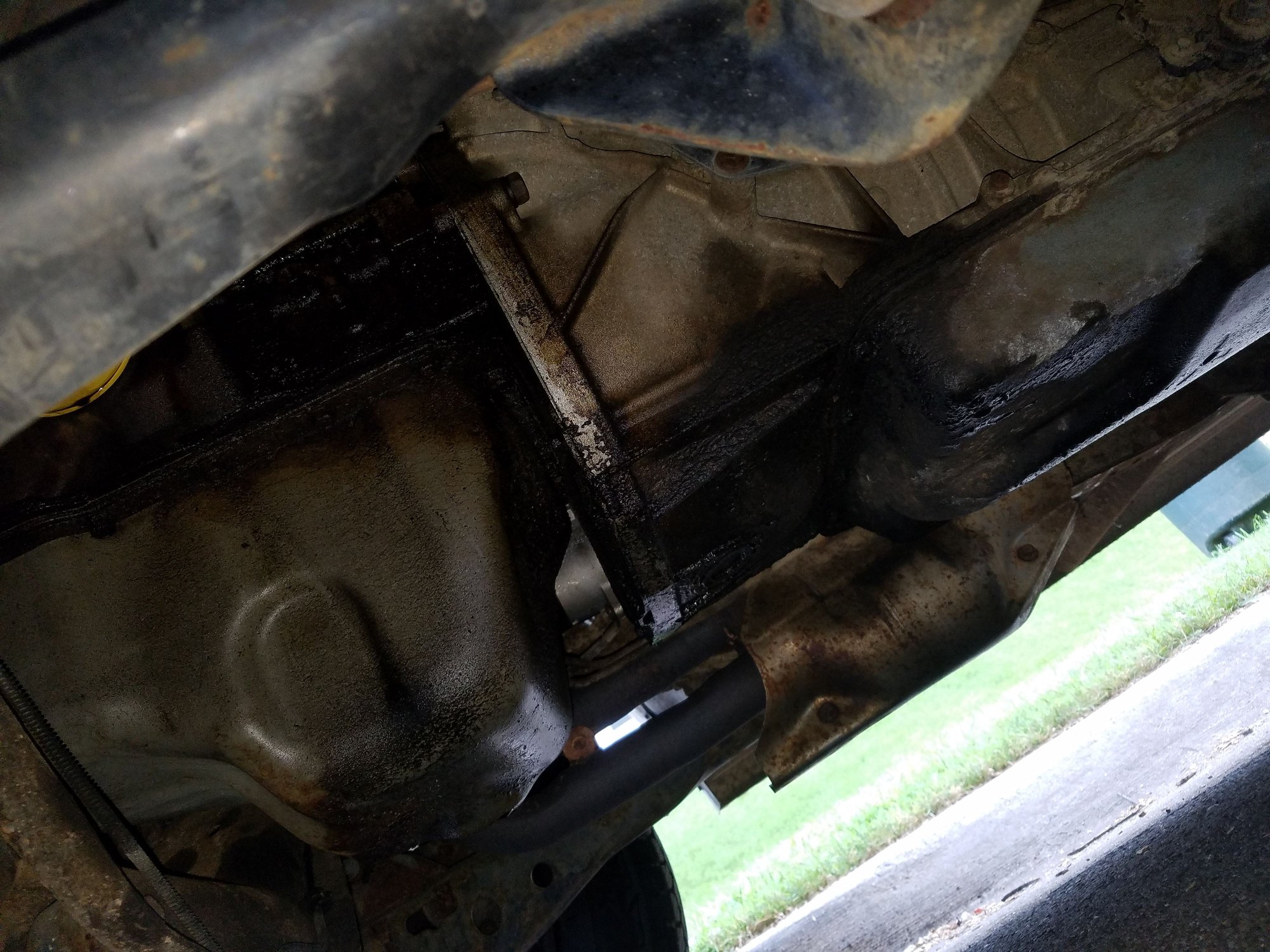

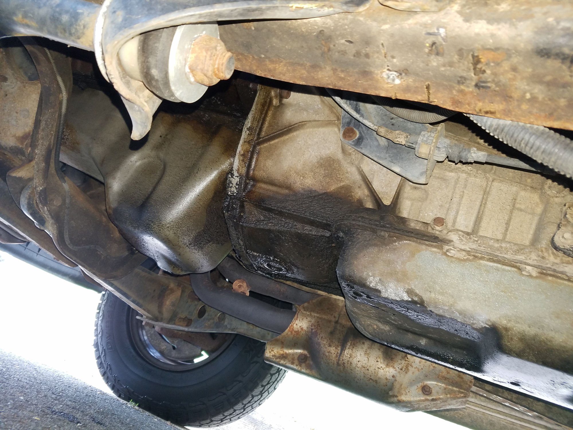

Leak
leak

Originally Posted by Em Erbil
It's shaking even when on a stand still
That suggests an engine problem, do a compression test on all cylinders.
The oil leak looks like a rear main seal, the trans is usually removed to fix that but figure out what is causing the engine vibration first, if it turns out you have low or zero compression in one cylinder then you may as well pull the engine.

Vibration may be the flex plate or torque convertor.
The oil leaking is possibly the rear main seal, but more likely the lifter cover gasket. Those are known to leak. You might get by with tightening the plug bolts a bit, but likely the rubber around them has cracked and split, and the gasket is probably broken in several places as well.
I put some oil dye in and ran it for a bit to confirm that mine was leaking from the lifter cover, and replaced it along with the plugs. It was not a fun job.
