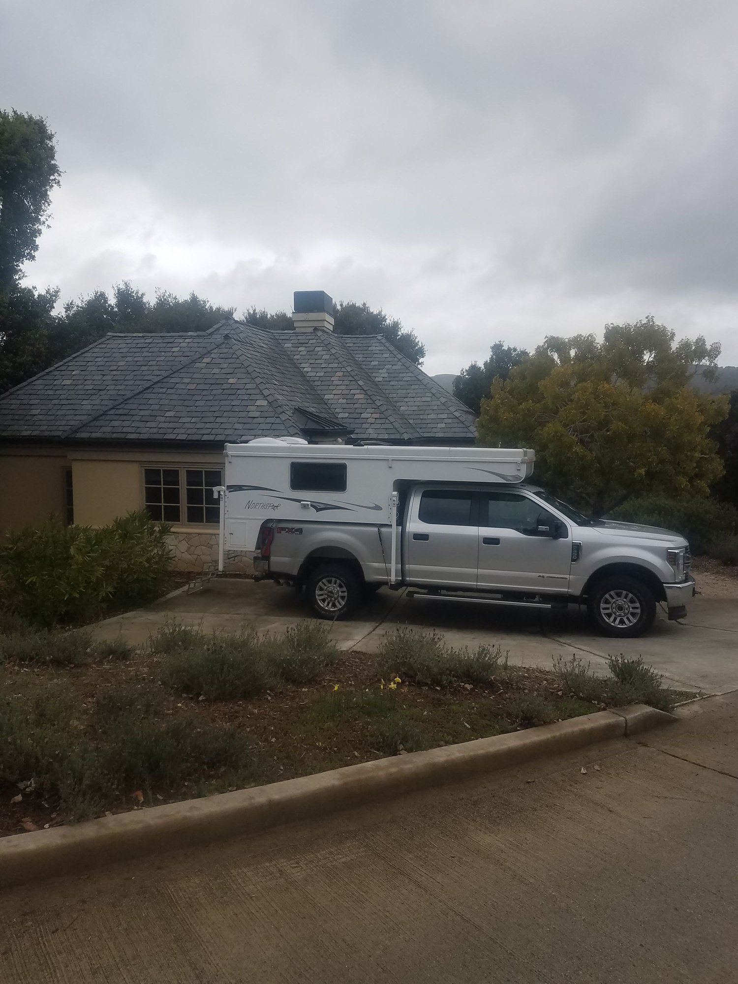

Did you ever get the 850SC and do you have any pictures of it on your truck? I'm looking to get the same camper on my 2018 F250.

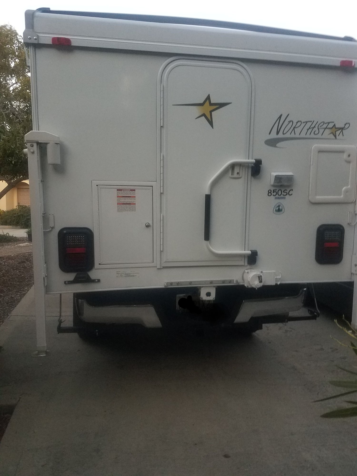

Ns 850SC
Pinnacles National Park with top up. Standing is about 6'4" and can almost completely sit up in bed.
Top down is really nice on forest roads and hwy driving.
Bku camera - ultimate trailer aux camera from Ford. Plug and play. Mounted low and it does its job!
Dealer added Timberin SS, bed pad, riser to clear bed rails and torklift fastguns/locks. Really pleased with everything.

Thank you very much for the pictures and info. It is a great looking set up. Do you have a sliding rear window and if so how well does it line up with the pop out window in the camper?

Sliding w
Yes - power sliding window and it lines up well. However doubt if I'll use it. I have ran an extension out the tc window to the 30amp plug connected to a jackery 1000 to test it...it worked but no need as i have the ac outlets on the unit.
