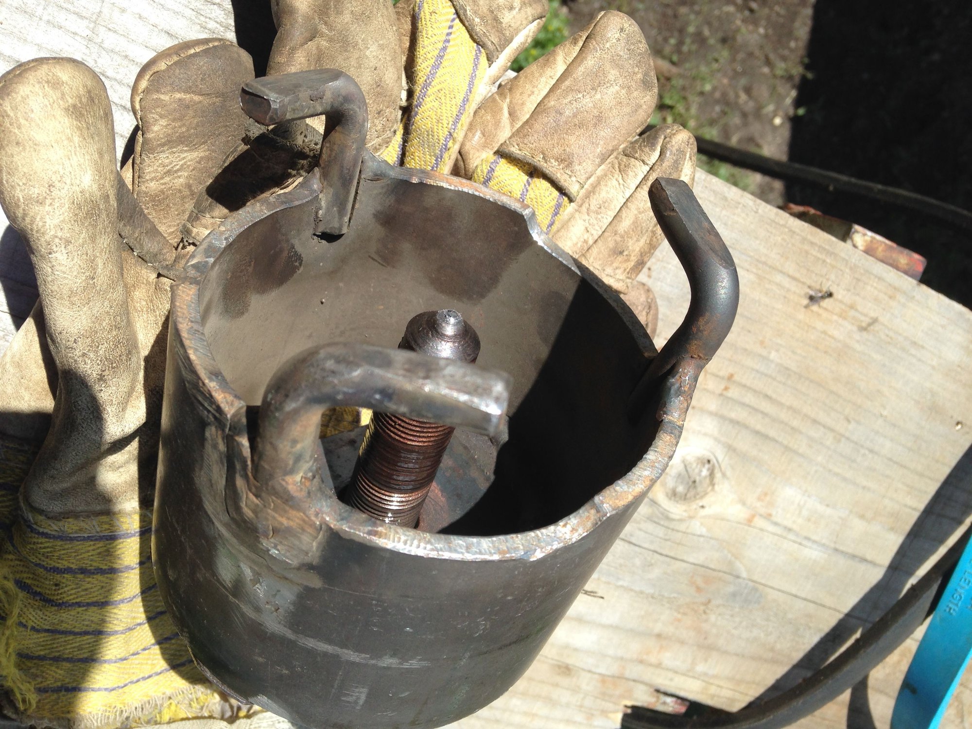

My apologies Krewat, everybody likes pictures! Unfortunately we are waiting on parts from the states for the hydra-deck dampener/v-belt pump pulley, so it will probably be another two weeks before we can get it assembled. I just have a picture of the old harmonic balancer and the puller that did more harm than good. Good idea on the puller, but it needed to be more "refined" in order to work properly; being fabricated squarely would be a step in the right direction lol. If I remember, I'll grab a picture of the pump setup when its all back together.
Tiny bit wallowed out
In theory, it should've worked well

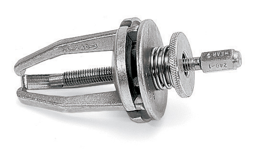

I have a three-jaw Snap-On puller that my brother gave me 30 years ago that would have done that job. Looks kinda like this, but maybe a bit beefier:
