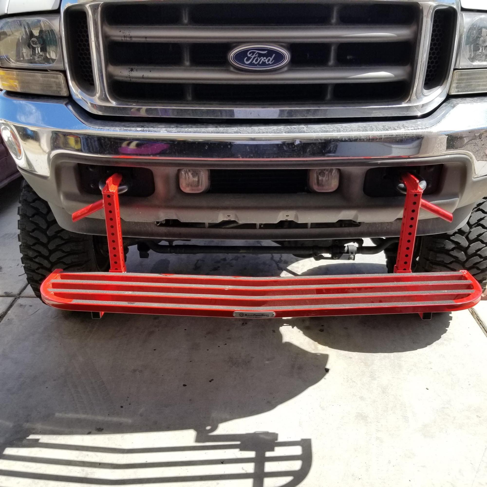

I was having some issue towing my 31 foot bumper pull. Hi coolant and oil temps. Fan never fully engaged like it has in the past. I have a switch for blue wire mod. When I would engage it fan would become fully locked but it would make a sequel noise and rpms were increased with it locked. So I am in the middle of changing fan clutch now. I went with Hayden 3261.
Old Jul 15, 2018 | 04:35 PM
dant's Avatar
dant
Joined: Dec 2003
Posts: 100
From: linden, mi
Do you need special tools to take off?
Old Jul 15, 2018 | 05:25 PM
vfelix702's Avatar
vfelix702
Joined: Dec 2010
Posts: 1,155
From: Las vegas nevada
i used an air chisel on old fan nut to break it free then it spun off. i used a 48mm wrench to tighten the fan back down with a slight hit if chisel to snug it down. 8 mm for fan shroud closet to radiator (2 bolts). and 15 mm for other half of fan shroud (4 bolts). Losened radaitor hold down clamps for more room (4 8mm bolts). and my step on front of bumper... pretty straight forward.
