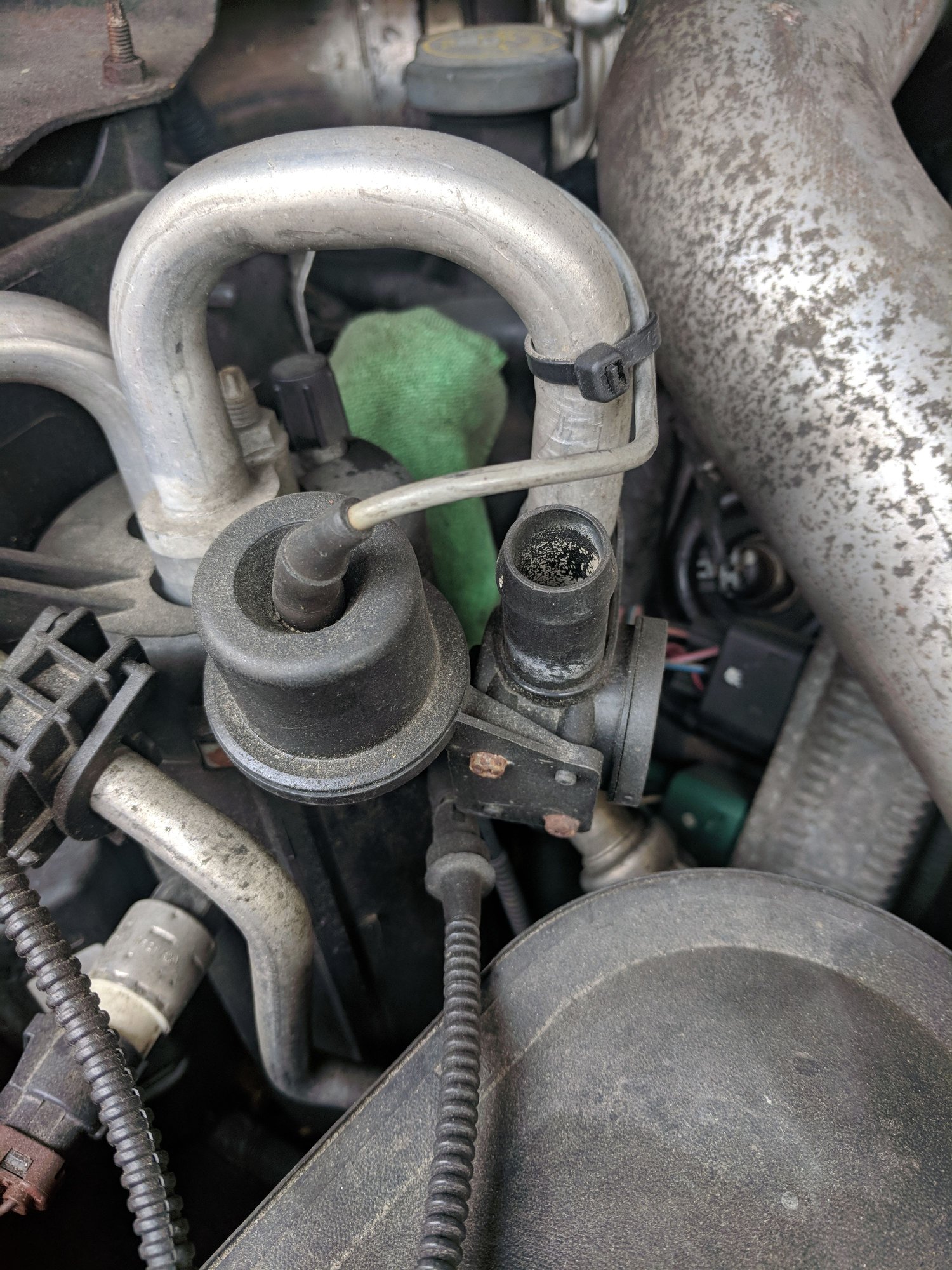

What is this?
Ive known about this since I got this truck but never gave it much thought. Now that my AC isnt blowing quiet as cold as it should Im wondering why the PO would have done this. Its not exactly the AC mod, right? Its just a straight fitting in place of the vacuum valve. Is this stopping my Max AC from working properly?

My SuperCab didn’t come with one but I believe all CrewCabs did. You can get a replacement valve or do as I did, put in a 5/8” valve with 5/8” copper tube.
Thanks. Think I'll get a replacement valve. I tested it with the vac line on max ac and the valve isnt opening and closing all the way. Probably why the PO disconnected it.

I'll bet the valve was leaking coolant. I'll bet your 4 wheel drive works after the change too.

BTW the valve closes not opens when in MAX A/C. It cuts off any hot coolant from the heater core.
So you could just block it and see how that does.

Could someone tell me which one of the many components is the valve in the photo? My A/C is not working all the time and my auto hubs do not engage, Tomorrow morning (in the cool of the day) I am going to check out the A/C with leak detector and my gauges. Perhaps I need to look at this valve also.Still trying to learn the 6.0 after 15 years. I have replaced the seals on the auto hubs years ago and I have notes on how to diagnose that part of the vacuum systems. Thanks.

second pic it has the grey vacuum line going to it. First pic if you look just left of the oil fill cap you will see a hose clamp that is where it would normally be attached.

Also in the A/C air box there is a little stub for parking the vacuum line if you don't have the valve.
The there are times when someone that did not know has put the line on the valve in the wrong spot.
If you look at the first photo of the valve with the vacuum line going to it that is the correct location.

Got the new valve installed and took it in to have the ac recharged.
Its 95 out today and my max ac is still only @ 57. Does this seem right?

Do you have the ac in the recircle position after it cools down? I have not recharged my truck but on my Jeep
i would shoot for anywhere between 40-50 degrees coming fron the center panals at 95 ambient. Recircle position should cool better after the initial heat is out of the truck.

On out trucks if they are sitting have a lot of heat coming off the hood.
So take it for a little drive and then retest it.

After a short drive I tested it again on max ac with fan on low. The temp got down to 47. I'm pretty happy with that. Nice and cold!
