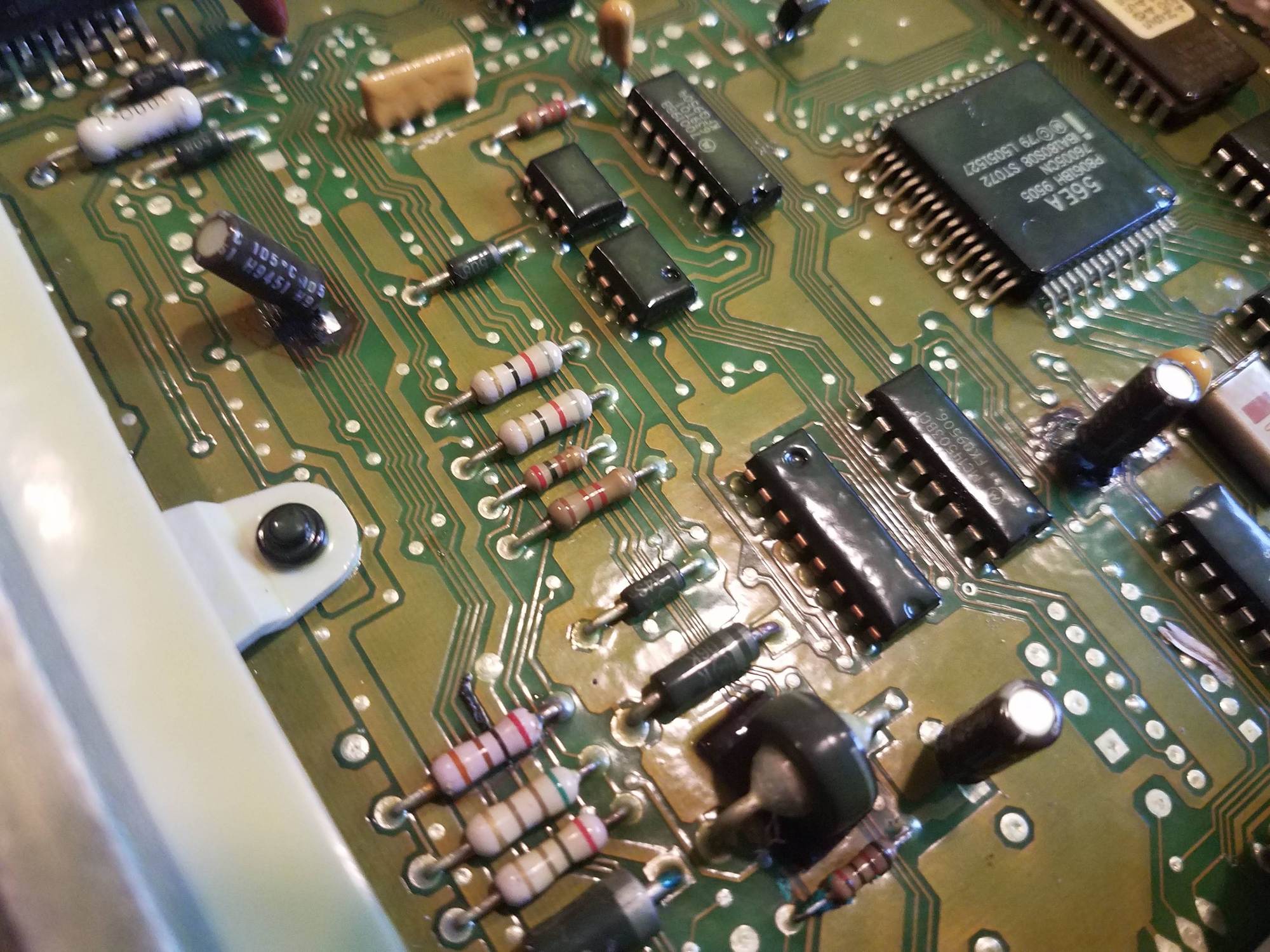

Drove the truck last night before having chance to really test anything further. Truck did fine on 5 miles trip to store, but when I started driving home, experienced the same symptoms I've been having - crappy running without any check engine light. Then the check engine light came on, and the truck started running more normally. I can't say it was 100%, but after what it was doing, it felt like normal running. So no light when running really bad, and light on when it starts running fine. I didn't have a chance to check the code last night though I assumed it would be the same rich code I got last time. Upon checking it this morning, I found it gave me 111 and 512 again. So...something is causing the computer too lose codes. Makes me wonder if it is partially causing the bad running.

If you are removing a battery cable to clear the stored codes then Code 512 is coming from that. If you did not, that indicates a problem with the computer. Since you did get a CEL while operating and there is nothing in CM that does point to a possible bad computer. Time to pull it out for an inspection.
I agree with rla on this. PCM needs to come out and I'm betting the capacitors are leaking or failing fast.
Anything with 20+ year capacitors are gonna fail.

I agree too! And no, the battery has not been disconnected between code setting and checking.
Will pull PCM this afternoon. Where is a good place to get a replacement or repair? I'm finding lots of places with wildly varying prices, and I don't want to spend money I don't need to -- or spend money on crap.

Nobody carries good re-manufactured computers (PCM) anymore. Most are carrying Cardone rebuilt units. Their QC is pretty bad. Best bet is to pull yours out and inspect. If there are obvious signs the capacitors are leaking, but no damage to the board, you stand a chance it can be repaired. Start there IMHO.

I have two leaking capacitors. So even if it isn't THE problem, that is a problem. So cardone is suspect. Any idea who I could send this one too? I'd hate to buy "reman" and simply get a 23 year old board that hasn't failed yet.
Leaking capacitors on top left and right
