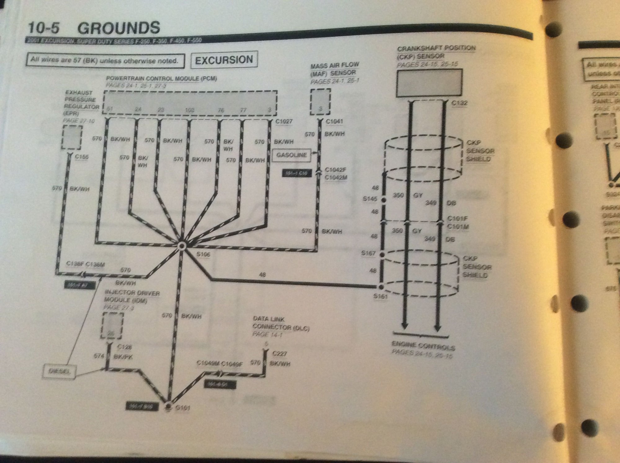

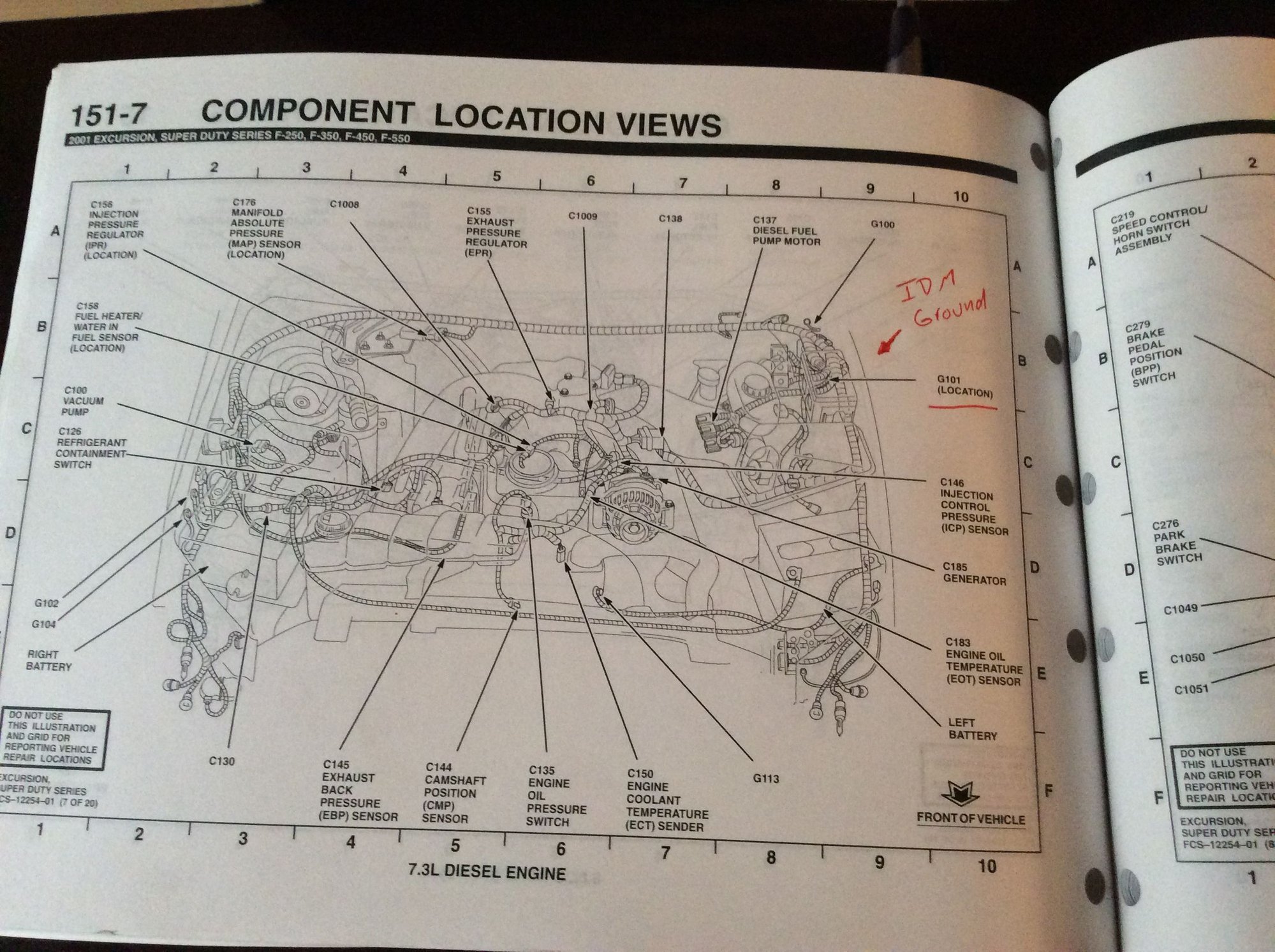

Since I am in the books this morning trying to solve my own mystery I looked up your IDM ground and pin out info.
The IDM shares the ground with the PCM and is known as ground G101 and is located on the inner fender right next to the air box lid.
Old Aug 11, 2018 | 09:08 AM
pirate4x4_camo's Avatar
pirate4x4_camo
Joined: Apr 2011
Posts: 8,259
Likes: 346
From: Northern California
Gxxx are the ground locations, as stated above the PCM and IDM ground is G101
edit: @exswap, book shows a total of 14 grounds on the excursion. Only 1 for the IDM
