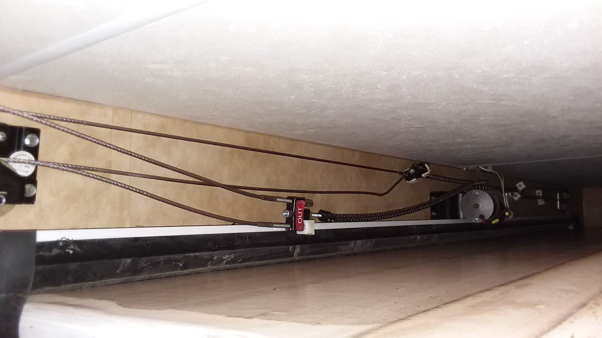

Something isn't right for sure.
the major problem I am having is the cable adjusters are getting hung up on each other when they slide past
the chain looks terribly loose, how much slack is there supposed to be?
looking for suggestions.
I noticed that on the top cable pair the one is really tight and the other really loose. Shouldn't those both be tight?

I think this is the service manual for you slide system: http://norcoind.com/bal/downloads/ac...ice-manual.pdf . I have only talked to tech support there a couple of times as this is a less common system, but I found them knowledgeable and helpful.

Thanks Steve! I'll check it out and see what I can find.
the lower cables look like I can adjust them up , but that one on the lower looks like it is stretched pretty far beyond the adjustment nut.

I have a Fuzion Impact with the cable operated slides and have had to make adjustments a couple of times. The link that RV tech posted is the one you need. Read it and make sure that you understand the concept of the "give and take" system and only then should you try to do an adjustment. With that much slack, are you sure that the cables are ALL on their respective pulleys?.....or that one or more of the L shaped brackets that attach to the slide room isn't bent?
Another issue I found on mine was that when adjusted properly, there really wasn't a way to "lock down" the adjusters. Mine had foam blocks on the adjusters and they don't do diddly squat to keep it in adjustment. Once I got mine adjusted correctly, I added another 1/4-20 nut on each adjuster then ran that but down against the adjuster nut, to lock it down.
Thirdly, in answer to your question about the top cable pair....yes, they should be the same. Again, read and make sure you understand the give and take system before trying to adjust anything. Also, make 100% sure that you have no issues with a pulley or pulley bracket, bent L shape bracket our a cable ends that is pulled out of the L bracket.
And one other thing....this style slide room with the cable pulls...seem to be pretty sensitive to the trailer being as close to perfectly level as possible....side to side and front to back. If the trailer isn't, it seems to increase the risk of a binding slide room when deployed or retracted. When that happens it put extra strain on the cables and sometimes causes them to stretch or to bend or pull loose an L bracket.
