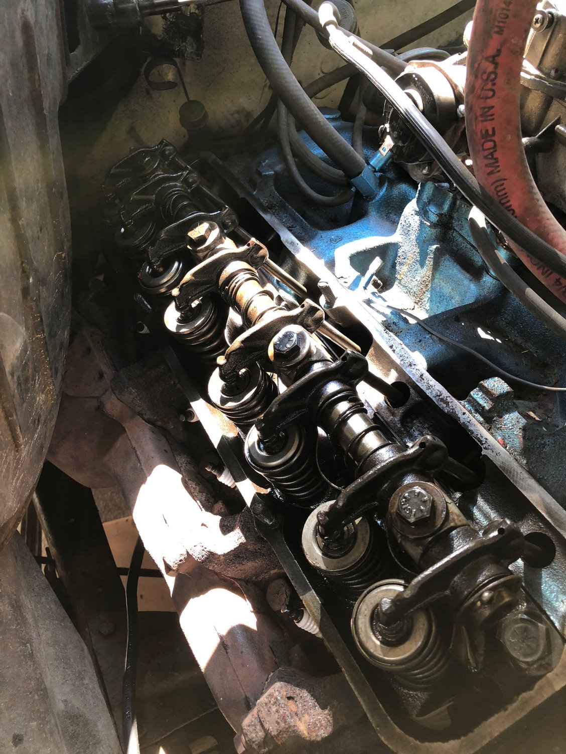

I have a ticking noise coming from the passenger side of the valves. Today I removed the valve covers to see if anything jumped out as causing the ticking noise. Some have said possibly a sticking lifter but not sure. I took a few pics and hoping some of you can identify any abnormalities. Some of those horizontal springs look odd, maybe even broke so not sure if that is what could be causing the noise. In pic 2 on the farthest rod t I just now noticed what appears to be some rust. Could that be a problem or is that normal? All three of this pictures are of the passenger side. Thanks in advance.

You can see that at least one of the springs that separates your rocker arms is broken. In your top pic. That could cause some ticking noise. You will need to remove and disassembled the rocker shaft to replace it.

It dose not look like oil is getting up there as it all should be soaked in oil.
You can run the motor with the cover off and make sure oil is coming out the end of the push rods & rockers.
If not you need to pull the push rods and make sure they are clear.

FEs are oiled through the rocker shafts, not the pushrods.
But good point, it does look a dry the OP should check to make sure the galleys in the shaft are not plugged when he takes them apart to replace the springs.
OP You can source springs from other rocker shaft or look up the part number and put it in the Google machine

Still, why don't the rockers shafts, bolts, valve keepers etc, look wet with oil? I agree, the whole area should be generally wet with oil, and a little pooled by the drain passages. Looks pretty dang parched up there to me.
It might not be a bad plan to pull the rocker assembly and spin the motor over and make sure enough oil is making it up topside. Then inspect the rockers and shaft for galling and sludge. The underside is where all the wear takes place, they may be junk. I went through this with a Y block. They are notorious for poor valvetrain oiling.
The point needed to be made for clarity. Pervious member suggested that the OP check his pushrods to make sure they weren’t blocked with sludge. FE pushrods are solid...I didn’t want the OP to get confused when he pulled his and didn’t see any holes in them. Also I agreed with his real point that the rockers looked dry...hence why I suggested he check his rockershafts for sludge build up.

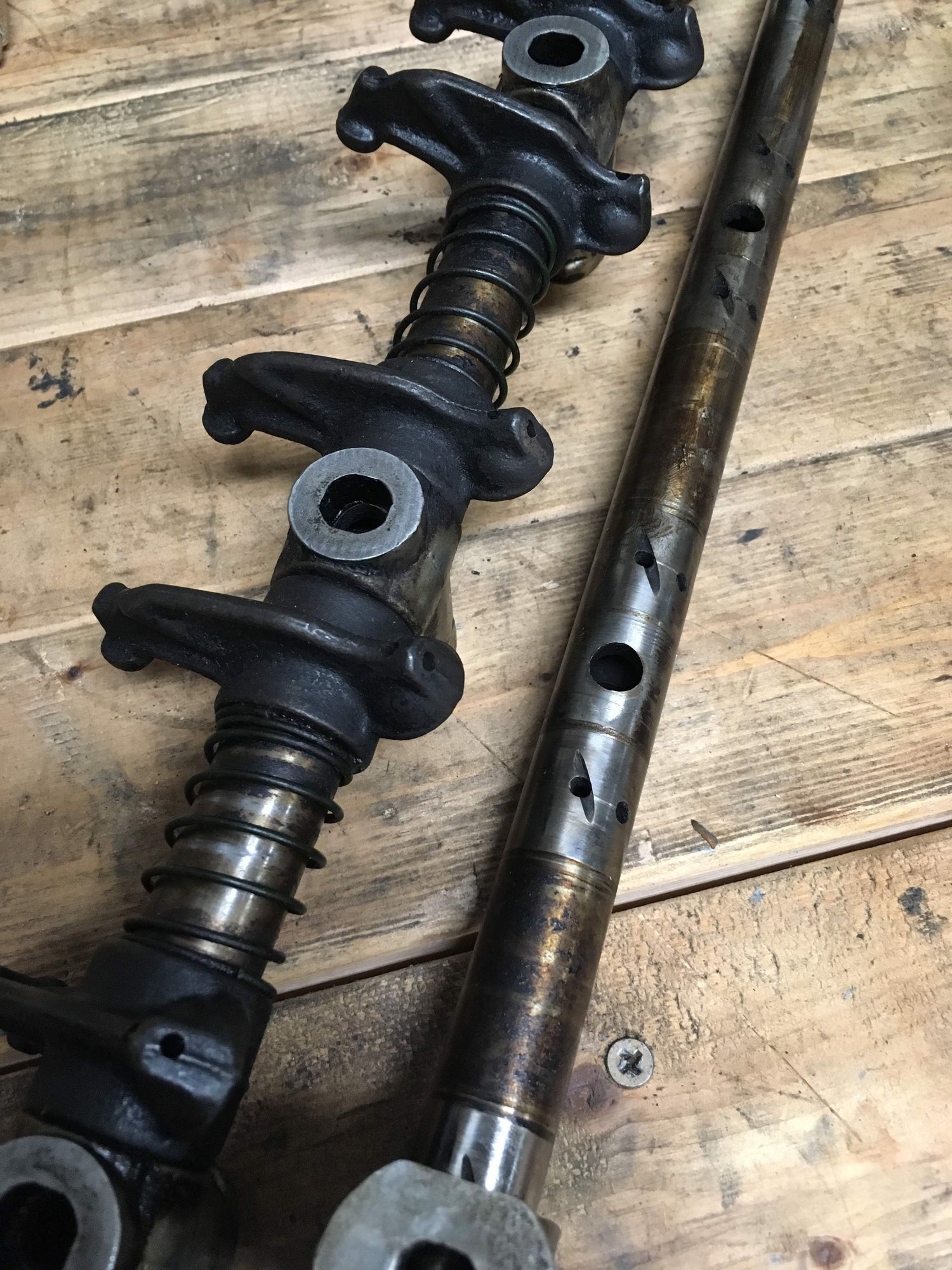

So the oil comes up thru 1 of the rocker shaft stands out across the shaft how does the oil get to the valve & push rod to lube them?
You got it. Oil flows across the shaft and through some passages onto the rocker arms. Once pressure builds the oil will flow from the rocker arms down to the pushrods and to the top of the valve stem. If oil is flowing well you will see it pumping out the two holes on the pushrod side of your rocker arms.
I had mind tore down the other day and snapped some pictures. You can see the oil passages on the underside of the rocker shaft that is tore down. If those get clogged.... bad stuff can happen.
