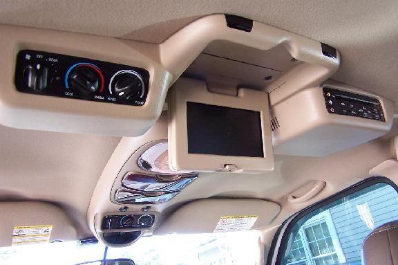

You sure it's a factory DVD system? Someone installed an aftermarket DVD in mine and the DVD, when down, blocks the rear controls at the aft edge of the upper console.
I think this is a good example of what the factory one looks like:
...and here's one without factory DVD (what mine looks like):

Sounds like mine. Someone removed the rear controls and added an aftermarket DVD with flip down screen setup. It did not work and when I took it down I found the wiring and plugs for the rear controls in the ceiling. Bought a used control off eBay, plugged it in and it works. Looks like GregA's lower photo.
I think this is a good example of what the factory one looks like..and here's one without factory DVD (what mine looks like):
Here's what I have. Factory Ford equipment it looks like.

That's not a DVD player I've ever seen in a Ford before. And that "Ford Motor Company" logoscript hasn't been used on products for a long time, if ever (it was finally removed from the Dearborn HQ in 2002.)
I think someone removed your rear A/C controls, installed an aftermarket DVD player up there, and slapped an ancient logoscript on it to make the owner think it was factory. Drop the DVD player down and I'll bet you a dollar-to-a-donut you'll find the wiring and plugs for the rear A/C controls.

I'm holding the aftermarket wiring for the add-on entertainment system. Above my hand, you can see the factory A/C control wires.
