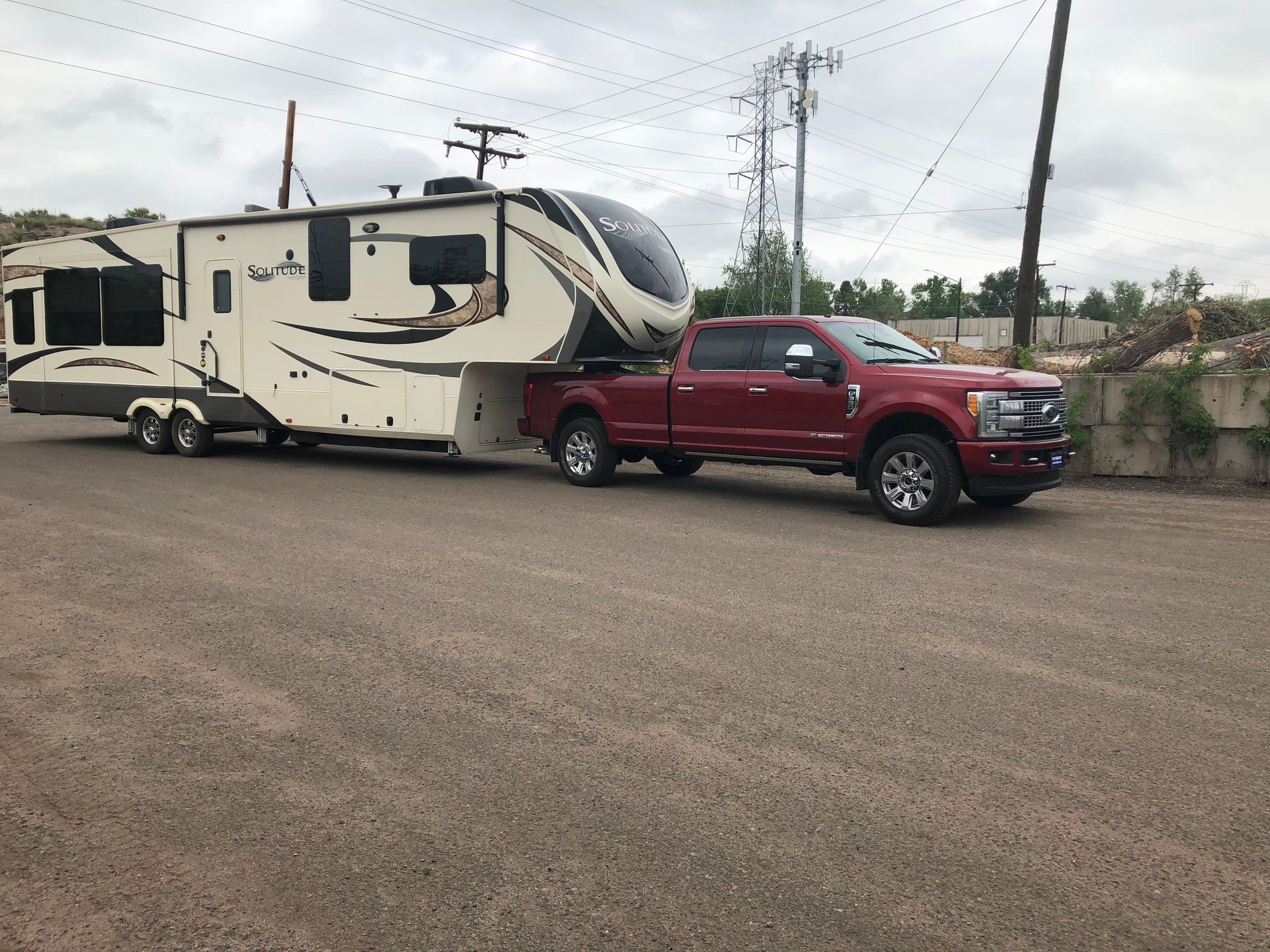

This is the trailer I’m pulling. 13940 Unloaded. About 1,000-1500 in payload plus a full tank of gas.
