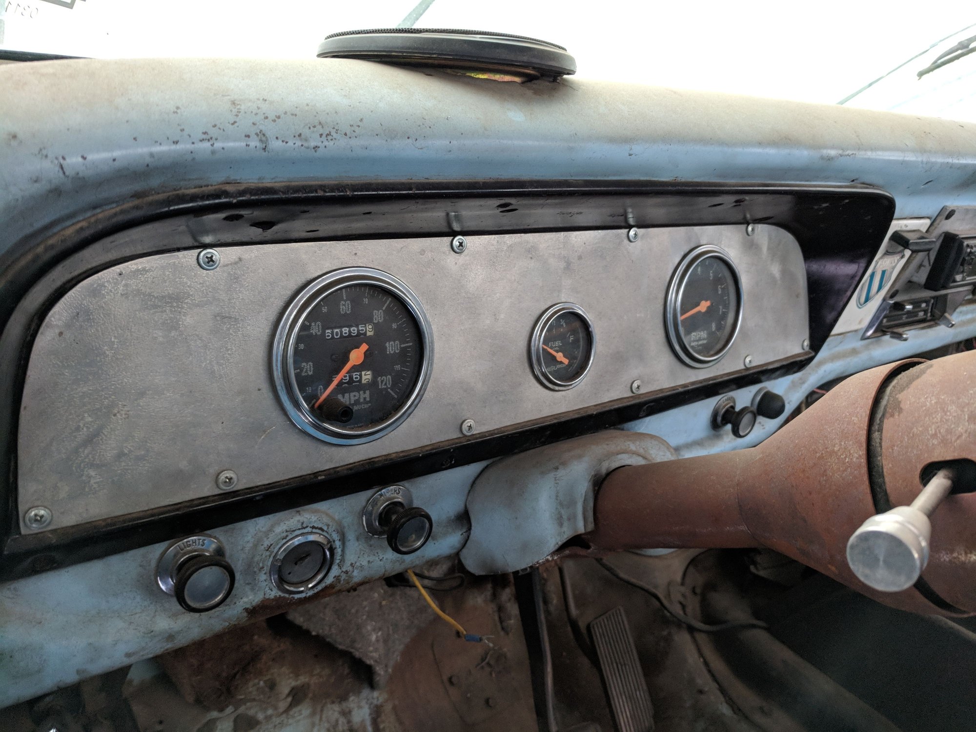

Just finished working on the truck for the day and I made a couple nice discoveries.
I was wrong about one shock being blocked by the drag link.
Also, it has an Edelbrock intake and 4bbl carb!
Add to that power steering and power brakes.
The only down sides besides the blown transmission is a hole in the driver's side floorboard where your heel goes, and a mess wiring wise for gauges and headlights.

You can get replacement floor panels, and find a replacement instrument panel-if you want. I guess the co-driver was suppose to keep an eye on the other gauges and not use the glove box. I think almost everyone on this forum has had a wiring nightmare under the dash.
