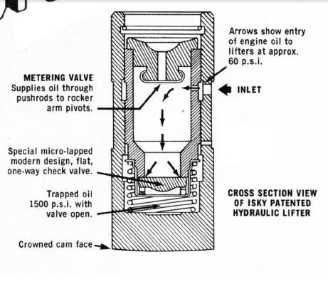

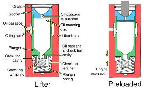

Quick lifter views.
Other then when machining the heads and valves, pushrod changes need to be made when the base circle of the cam is altered. If that was done with later cams, then Ford should have issues a TSB.
