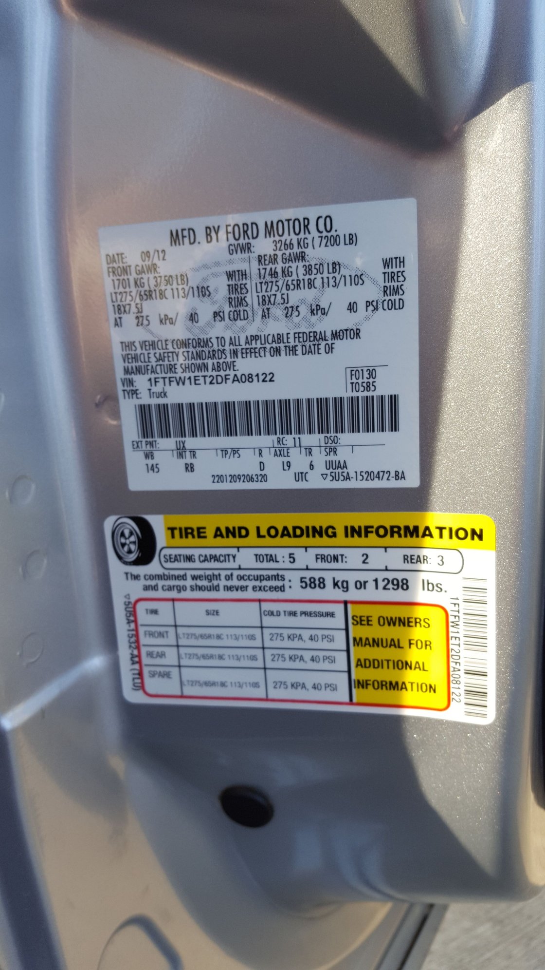

I was on a fishing forum i belong to and they have a towing and trailer section , Mainly about boats of course. But one guy posted he uses his axles ratings to determine how much his payload actually is. So looking at my truck the GVWR is 7200 Lbs but the front axle is rated to 3750 Lbs and the rear is 3850 Lbs so the total is 7600. And according to the PA registration my unladen weight is 4150 ? So how does this get to my payload of 1298 Lbs ? not looking for absolute answer just more curious .

Your registration weight is wrong.....it's way off! 7200 minus 1298 = approx. 5900 lbs....give or take a couple. Your truck weight, as it was built was 5900 lbs. and that includes a full tank of fuel and an allowance for a 150 lb driver. Anything and everything that has been added to the truck.....tool box, bed cover, etc, is then deducted from the 1298 number.....if anything additional has been added.

The correct technical answer to your question is to fill up the truck with gas, and drive it across the scale. subtract that number from 7200 and that is your payload capacity.
you can go up to 7200lbs so long as the weight on your rear axle doesnt exceed 3850 and the front axle doesnt exceed 3750
the 1298lbs on your sticker comes from the known weights of your truck with all the options your truck came with. it is not going to be 100% accurate, but it is going to be really darn close, and IMO, is good enough to go by.
1298lbs is a very low payload capacity.... which is a result of all the options that come on the FX4 trim.

Your GVWR will always be a little under the sum of your GAWRs. It is a safety margin. It would be highly likely that if you loaded your truck up to the sum of your GAWRs, one of your axles would be over weight.

Not really.
upgrading all of those components will make it handle the weight better, but nothing will increase your payload because it is dictated by the GVWR and the curb weight of the truck. The only 2 ways to increase your payload from the factory rating is to reduce the curb weight, or raise the GVWR. Raising the GVWR is possible for certain commercial vehicles and specialty vehicles, but i don't think it is a service available to the masses.
In my state, if you add an axle to a vehicle (think Straight truck, or Semi truck, not pickup), you can register it for a higher GVWR, but that is for Farm and Commercial. on those vehicles, GVWR is taken very seriously and you DON'T want to exceed it, but then again it is usually based off the tire footprint on all of the axle groups since the total weight (GVWR) on these vehicles are dictated by the pounds per inch of width for a given tire.
