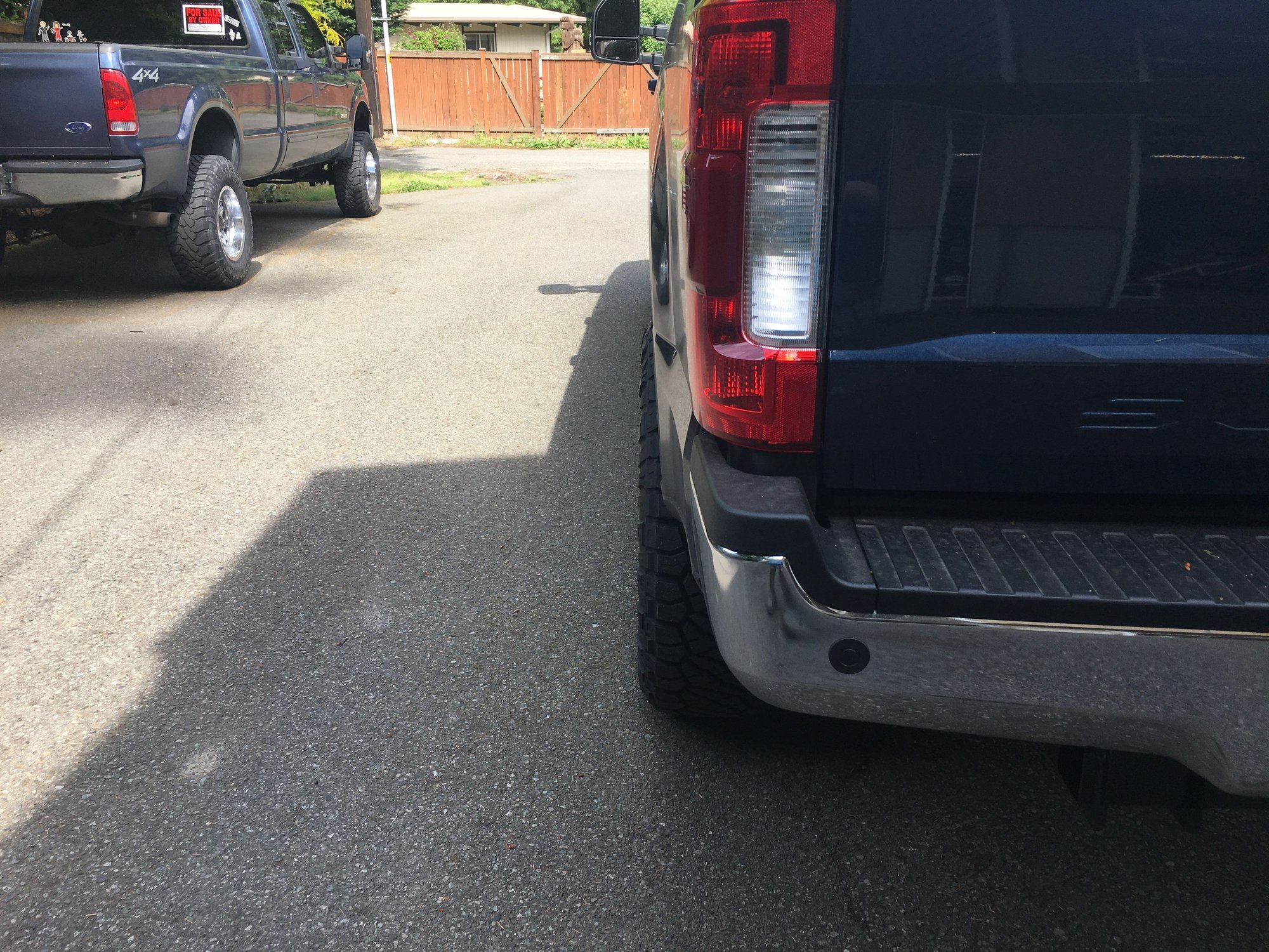

So tried my full spare nitto ridge grappler 295/65/20 and it fits but nothing bigger would. One of the reasons I didn’t want to go 37” tired of have full spare in bed.

Thanks for the pics. I just put on 37s and was wondering what would fit under the bed.

The 295 is taller then a 35... but no way in hell a 37” would fit.

Yeah, just trying to figure out the biggest I can fit in there to get close.

Excellent.thanks that's the exact tires I'm getting. Would you mind paying more pics of the rims and tires on the truck?

Here you go. 20x9 +12
