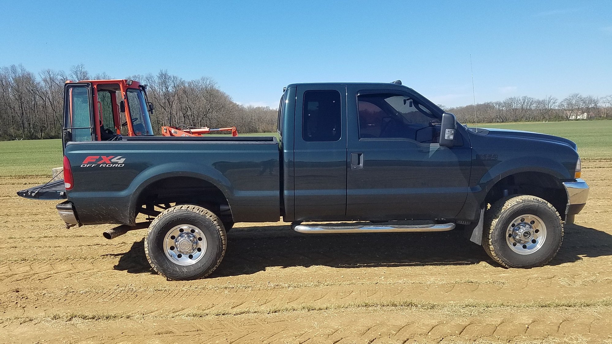

Heres my 2004 F350 last spring loaded with two pallets of fresh rolled tall fescue sod. Operator told me it was 3800lb and change when I paid. Truck went down about 4" YET I still had plenty of clearance before the bump stops would hit. Drove 18miles home and never hit the rubber axle stops. Yous have seriously weak springs if 2k makes your trucks bottom out

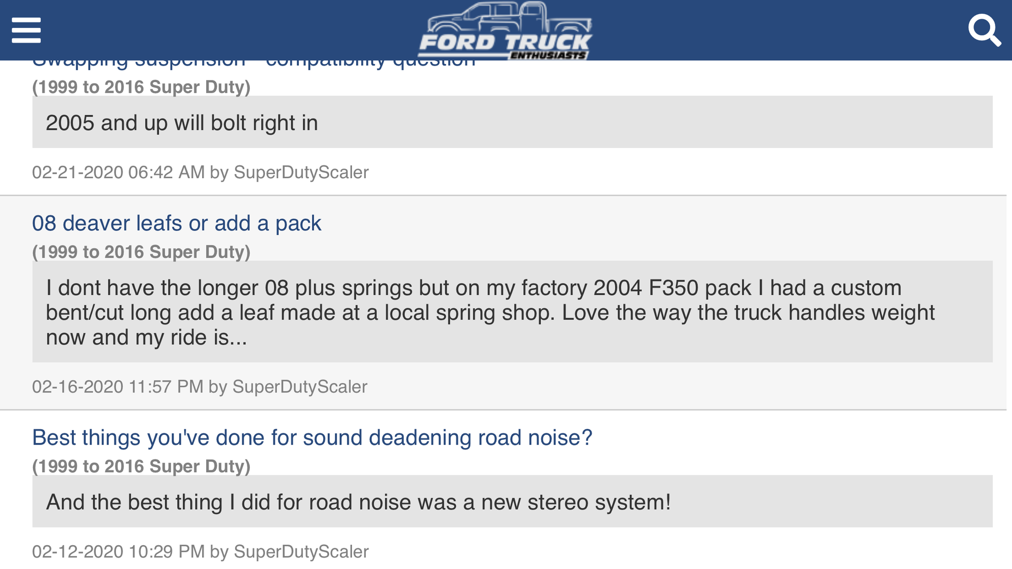

you forgot to mention you have a custom leaf pack added to your truck.....why did you do that.....thought so.
